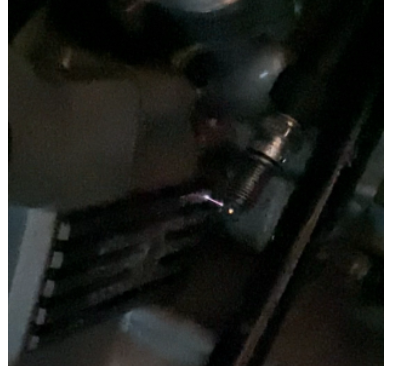

Still having some trouble. I've replaced 3 coil packs and for sure, I think there has been improvements. But now the battery is dead again and I must wait until morning... sigh. I was concerned about top right coil pack and replaced it, look at the beast go now. It doesn't appear to be 'as frequent' as the other sparks, they're like spark spark spark -- this one is like spark,,,,spark,,,,spark -- that matter?
It's GOTA be running on 3 still. While it was idling I checked exhaust heat and we're indeed back to 1/2 heat on the left side. I'm just gonna replace all the coils and go from there. I think probably at high RPM there is more voltage and is jumping the gap. She has NO PROBLEM at high RPM. I feel like I lose spark at low RPM. Also I totally put a Needle in backwards! Dope! I can only get her started with quick start. I have the idle adjusted to what you can hear. BOGS on throttle rev Once it picks up it definatley revs too high and eventually comes back down If I cover the airbox with my hand for a second she revs up, which I am assuming is right and she is just sucking more gas like a choke I THINK I'M CLOSER!!!!
