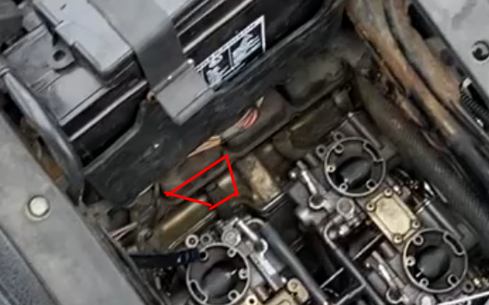

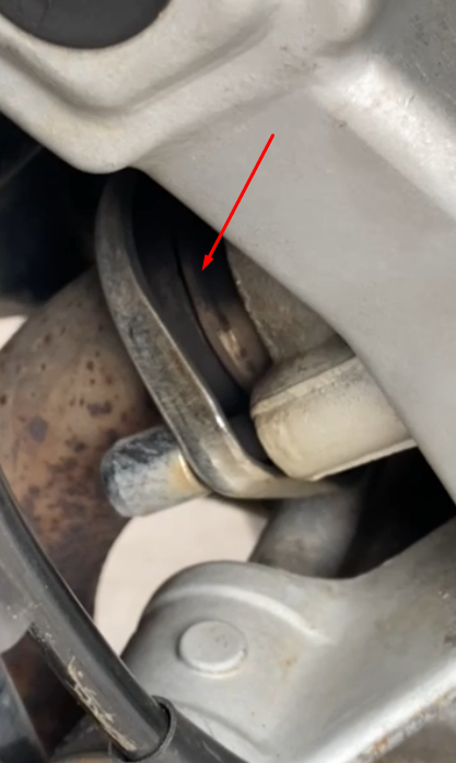

Here's what I was able to figure out: You can totally sync the carbs by ear to a large degree. It turned out that my gauges say right on them that a possible air leak may be detected if no reading is being found, and infact I found a house that goes to these weird boxes beneath the CDI's. Hooked that up and boom I'm getting 3/4 gauges and they're all happy. Bike starts and runs good, but not *perfect* as I still have that 4th gauge that is crazy. Upon lifting the air box I can see that carburetor is going nutty, I'm wondering if something internal didn't seat right, perhaps that little tiny o-ring I mentioned previously on like page 3, might have to ensure that sealed correctly. I also have an exhaust header leak from when I bottomed out getting her off the trailer. But if I had a back-pressure issue I'm sure carb 2 would be outa whack as well, so I'm lead to believe it is infact the carburetor with some small airleak. Maybe that diaphragm is toast after all, luckily my new kit arrived. She also blows a lot of backfire as seen here. So I'm getting WAY closer to perfection and it's been a blast 3 of 4 carbs synced.mp4
