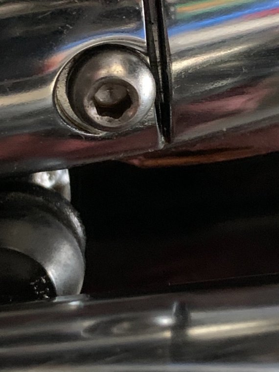

My wife’s car is in the shop so I said honey take my car the weather is going to be great and I can ride my bike to work. I checked the oil and tires and a quick run around the neighborhood since I hadn’t ridden her in a while. After the second day I decided to go round and tighten up bolts and screws and have a look at her. Uh oh I see a missing bolt . This bolt goes through the fork leg to hold the right brake caliper on there are two bolts upper and lower. Next day I’m riding home and my cup holder flys off and lands in my lap. I know it’s not a car but it’s a little scary to know things can vibrate off even when you do a quick inspection. So just a reminder check your bike before every ride cause you never know!

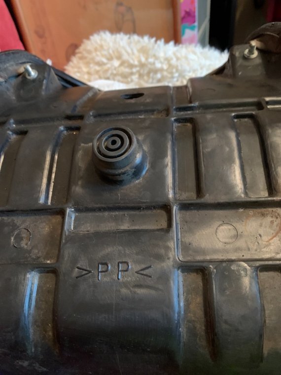

Okay I’m updating even though feel like a dummy but I did put a damp rag in the crack and it removed whatever it was in the crack. I really thought it was a hole with foam seeping out but thankfully it was not 😂. Thanks guys !
Hey guys I found a small pinhole in the seam of my seat , what would you recommend to stop it from getting bigger? Thanks

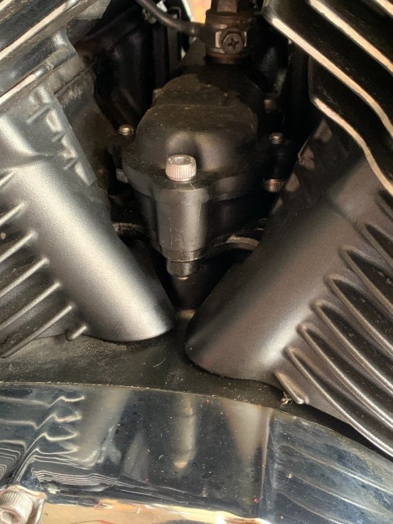

Hey guys I’m being lazy cause I know someone will recognize what this is and how to fix it quicker than I can look it up. Yesterday I was getting ready to ride after bike had sat for a couple of weeks and I noticed a small dribble of oil running down the chrome case cover on left side from above. Here’s a picture of the component that was leaking I think at the bottom is a gasket, so maybe around that. What is this component and have you seen it leak before on your bikes? Thanks!

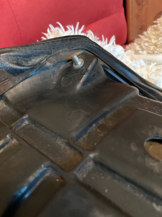

Hey guys anyone know what size nuts go on the bolts at the front of the seat that attaches it to the frame ? Mine must have vibrated off. And if anyone has a picture to go along with it that would be great too!

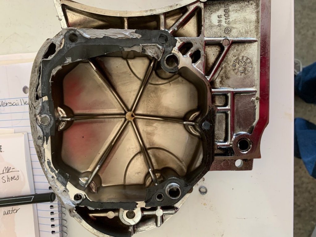

Update. I ordered the gasket after this mechanic said I needed it and then said I didn’t need a gasket I needed the cover because it was somehow damaged. I decided I wasn’t going to let him work I my bike anymore, so I took the cover off and dang it looked like a silicone bomb had gone off in there. No wonder it was leaking. It looks like when he worked on my shifter he removed the cover and didn’t replace the seal he just silicone around where he had torn it. Anyway I got all the old gasket and the silicone off and applied a gasket sealer called gasgacinch. This stuff had a lot off good reviews so I got some and no more leaks . I missed quite a bit of riding time waiting on a gasket he ordered but never came in . Anyway water under the bridge and I got to ride this weekend !
So I drained the oil while I’m waiting on parts. I’m posting a picture of where I see it leaking. I ordered the whole gasket for the cover but later found out there is a crush ring on the bottom bolt so I ordered that last night. I looked it up on partszilla site they call it a gasket not a washer so hope I got what I need. Hard to see but the oil is on that bottom edge of the middle cover on left side.
