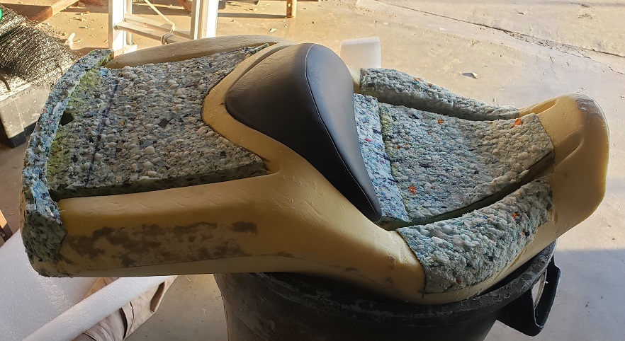

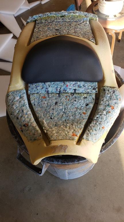

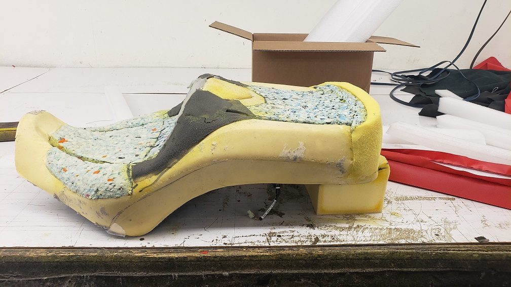

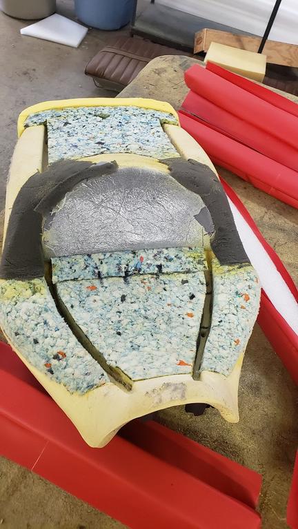

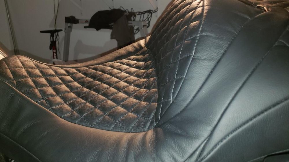

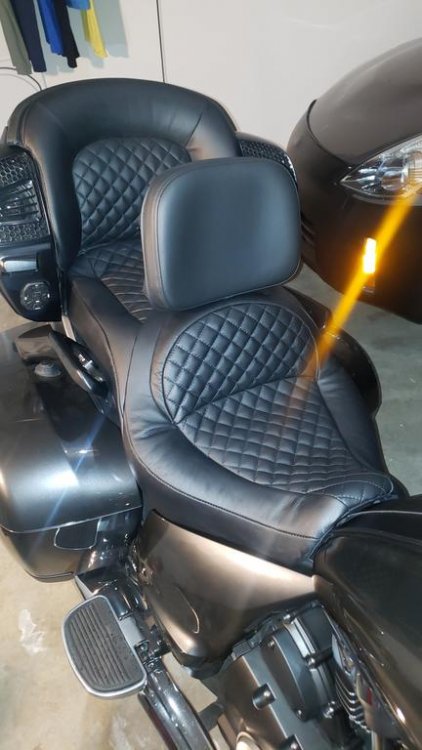

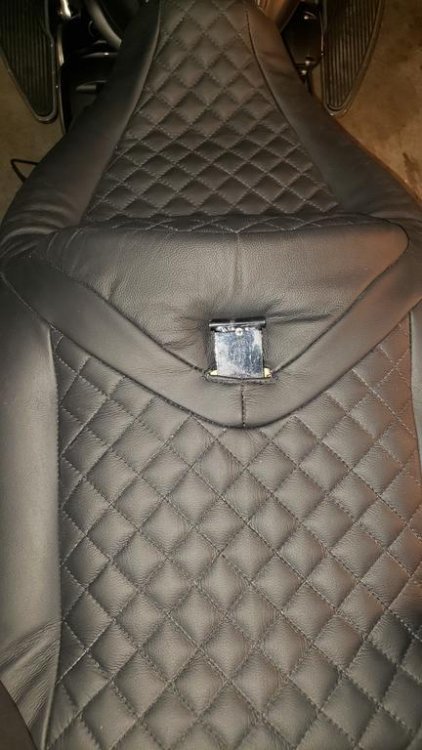

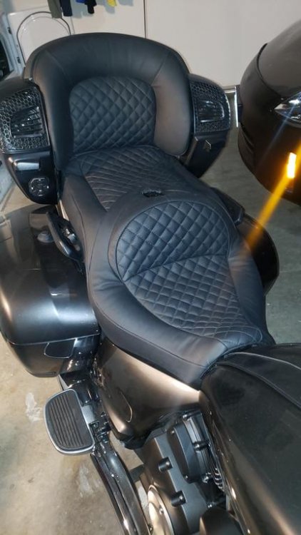

	So I have only had the opportunity to ride it about 150 miles (work and the holiday) but it felt pretty good. The area where the seating surface blends into the lumbar pad is 100% better and supports my tailbone area much better. I need to get it out for a 300 + miler and really get a feel for it. Hopefully this weekend if the weather doesn't go crazy. The guy that did it works for Lancaster Auto Interiors. I found him through a guy at work who is a car guy. Mind you this is his first undertaking of this kind, re-designing a motorcycle seat. He had re-upholstered a few. He was extremely busy during the time he had my seat and worked on it a few hours a day, all told it took about 2 -3 weeks from start to finish. To answer questions about shipping I am not sure, as he was local to me. I also supplied my own padding which was close to $100. He can probably do anything you want done like raising the stock lumbar pad, although he may have to extend the frame of it to keep the stiffness in it. I think he would entertain doing more projects like this one. You have to remember I could go there and brainstorm with him with the seat in front of us both. He also works at his own pace with it and has many auto projects he does at the same time so you would have to be prepared to be without your seat for a few weeks. If it is long distance you would need some specific photos or drawings of what you want. I gave him photos of a couple of different seats so he could see the slope from seating area into the backrest. All told it was a bit over 2/3 the price of a Corbin but retained the stock look, factory heating and the diamond pattern on the seating surface looks fantastic live, as well as getting rid of the gap between pillion seat and backrest. I also used leather which made it a bit more expensive. And I benefited from being the first guy to do it. I'll let you guys know how it is on an extended ride shortly
	Here are the pics of the finished product Here it is mounted without Utopia backrest on, Looks pretty good huh? I like the diamond stitching looks good with the style of bike. Notice no gap at the back of pillion seat. Side view of my seat with a bit of curve now into the (now stationary lumbar pad) The lumbar pad in now fixed where I ride 99.9% of the time. It has also been built up about 1" higher you can see how the gaps around the lumbar pad were filled in and the Utopia mount And finally with the Utopia backrest mounted. So should I diamond the Utopia facing? Too Much Diamond? what do you guys think? I will take it out and ride Sunday ( Going to the Long Beach Motorcycle Show Saturday) But it feels pretty good sitting still. Factory seat heater working fine. So far very pleased.
	One of the things that I have disliked about my SVTC is the seat. Too soft, gap between the rider seating surface and the backrest there sinks after about one hour giving no support to the tailbone area. The huge drop off and gap on the back of the passenger seating surface. I have always replaced my two Goldwing saddles with Corbin's and loved the firmer padding that takes forever to breakdown...if at all. Not happy with the looks of the Corbin for the SVTC and the absence of factory heat (and about a $1500 price tag) led me to modifying the stock SVTC seat with a local upholsterer. I started by realizing that 99.9% of the time I ride with the adjustable lumbar pad in one place so I measured that distance from the center of the pad to the nose of the seat. Second, I Installed the bracket for the Utopia Backrest and off to the shop I went. I talked at length with Dave at the shop and wasn't too fond of any of his available padding options. SO I went to google and purchased my own Rebond foam in 1" and 2" pieces. SO then we pushed the lumbar pad all the way back, took the cover and pad off and redid the foam so that it filled out to the measurement I wanted to the front of the seat, and added a bit of a slant to the foam. Then the center seating area for the rider and passenger were hollowed out and fitted with the 2" foam. A slant up into the lumbar pad was added for me and then an extension and upward tail curve will be added for seating area for the passenger, after which another section will be sewn into the leather cover that will join with the passenger backrest, eliminating the gap between the two. The passenger backrest will remain the same except that it will be covered in the new leather. in this first picture the rebond foam has been placed into the seating areas on both seat as well as where my thighs are supported. The lumbar pad has already been re-done and is in it's fixed position The second picture shows some of the mock-up of the rear tail section at the start. You can also see the new slant in the lumbar pad and the filler for curving the seating section into the lumbar pad. In this third pic you can see the dark gray foam that is soft and used to fill the gaps around the lumbar pad and is used to shape and fill gaps to make the seat look smoother. The light gray on the lumbar pad is the factory heater. you can also see the tail section in another stage In this last picture there is about 2 hours of work left to the padding part of the project. Here you can see the tail section lip, which will be redone to come up just a bit higher to fill about half the 2' gap between the seat and passenger backrest. Also you can see the curve of the rider seat into the lumbar pad, the gray filler foam and the seams that it will fill. The Utopia bracket will be put back on in this part of the project. I rode it for about two hours like this and it feels soooo much better without any breakdown in the padding. The seat will have the factory heating elements put back on, then the seat will be covered in black leather that has a soft 1/2" foam backing on it. The seating surfaces and the passenger backrest will have the insert stitched with a diamond pattern to provide a touch of pillow like softness over the stiffer foam. It may be finished by the end of this week (waiting on the leather) or early next week. I will post pics when it is all done. About half the cost of the Corbin while still keeping factory heat and the lines of the stock saddle. Thanks Dave
