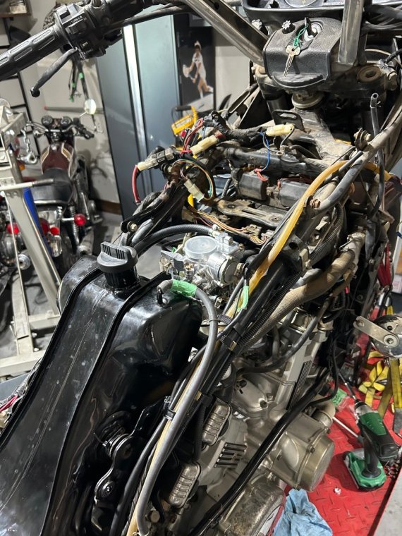

It couldn’t be this simple!! Positive battery wire was loose… really?? She fired right up! But….. tach is out. I did check #2 and it does have spark. Bike is back up and running though, will keep assessing on the tach. -
Bike was running great and now. …. Urgh puff of smoke / loud pop coming from single carb . Bike does not run. All electrics work . I have spark on all 4. If my Cdi was bad , I wouldn’t have spark, correct? any help is appreciated.

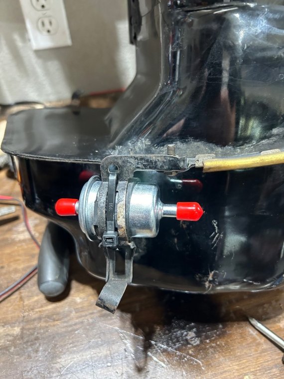

I still have my venture with its single carb and she still rides amazing! I did just trade an old bike for a 1986 Suzuki cavalcade 1400 and its engine looks very similar to my venture. have an issue I’m hoping someone could figure out. It has its original 4 carbs and the bike runs but…. It is popping back from the carbs at low idle with slight hesitation. some have suggested a lean condition. I put in a new fuel filter and have new plugs on the way. the bike did sit for a few years but the fuel tank was clean . at higher speeds the bike runs amazingly well but just have this low rpm missing/ hissing pop sound coming from the carbs , which is intermittent. thoughts??

Update!! Replaced the tci box and she’s up and running on all 4 cylinders again! -

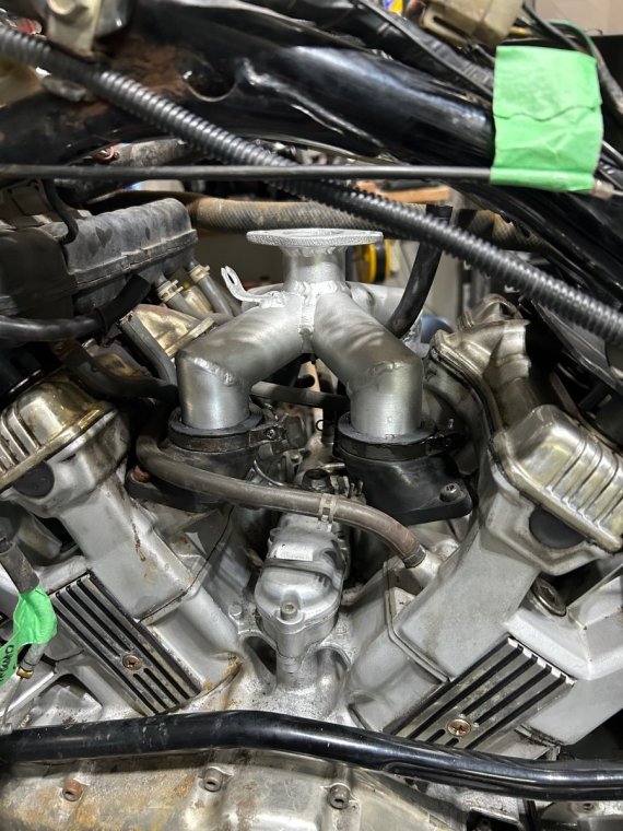

1983 venture and here is my issue. no spark left front plug. Other 3 plugs have spark. I have a new plug wire on it, new plug and last week I switch the back plug wire and got spark , so I isolated it to the coil. Ordered a good coil and she fired up with spark. Went to start this morning and again , no spark on front left ( I’m assuming that’s #2). please help, thank you

Okay….. lots have happened in the past week. Completed the single carb and she ran beautifully, then…… started misfiring and my tach is now not moving. I checked for spark and 3 plugs have spark but no spark on front left plug. I put a new plug , boot and plug wire in and still no spark. I then checked the coil by swapping wires and I got spark . I ordered another coil, if that doesn’t fix it , will have to get a tci module I guess
