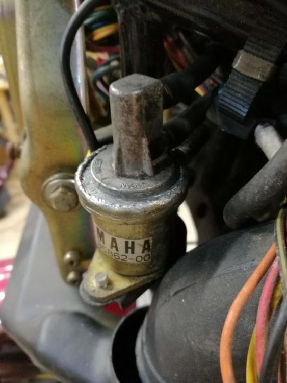

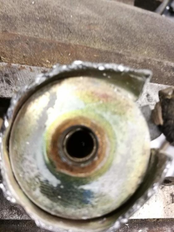

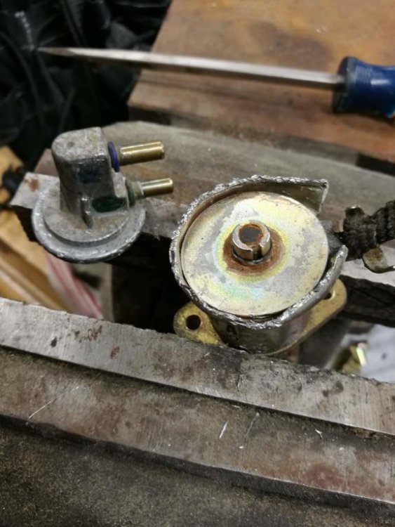

  8. Nope it did not buzz and didn't notice it heat up but I didn't leave it on for more than a couple seconds. I opened up the solenoid which was a pain. I found that everything looked okay and it was just a corroded around the moving parts (spring and plunger). I stuck a rolled up 220 sand paper inside and cleaned up the rust. Drop of oil and its working as it should. I was able to blow through it when energized. I put in back on the bike. Haven't tested it yet cause I have some other things to work on the bike but I'm hoping that was the issue.
  9. Ok I played around a little this morning and I think this might be the problem. I ohmed the solenoid and it's not open (good) but when I applied 12v and Gnd to it, it does not click. Nothing happens.
