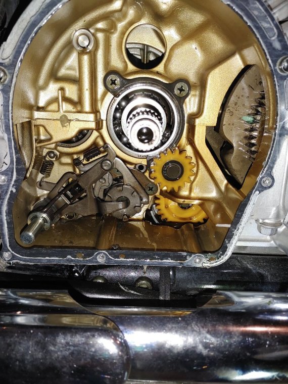

Good morning, Carl... The following is due to lack of knowledge...if the pan will come out the bottom with the engine in place, what prevents it from going back in? Isn't the oil pump pickup the only thing hanging down into the pan? I'm going to drain the oil regardless of what else I find, since there was clear evidence of metal shavings and small pieces on my magnet fishing expedition, and I was thinking that by dropping the pan I would not only find those missing ballbearings but also be able to clean the screen on the oil pump. I guess all this is because I was hoping to get the bike running again myself...with help...without losing the rest of our short season waiting for a time-slot in my mechanic's shop (late fall at best). If the motor does indeed have to come out, I'm done for the year.

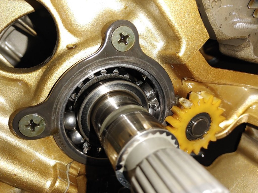

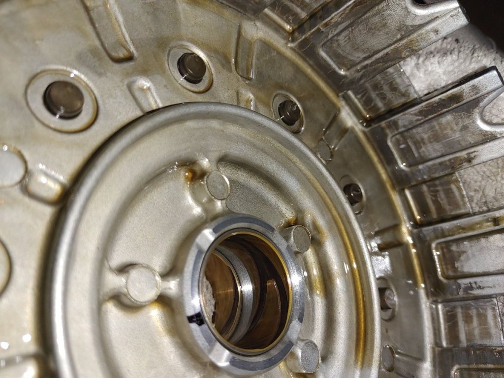

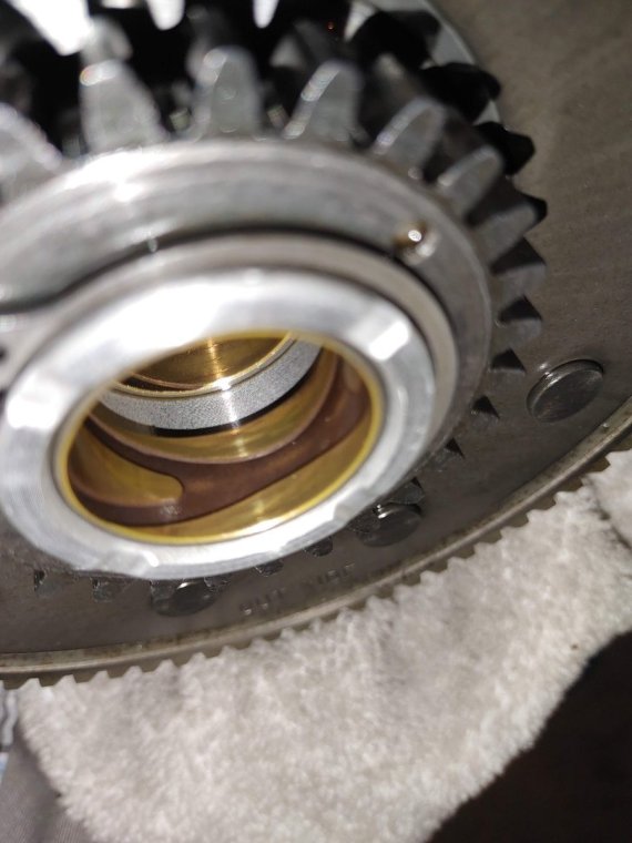

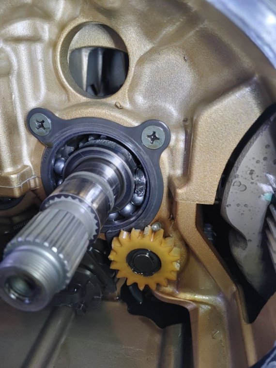

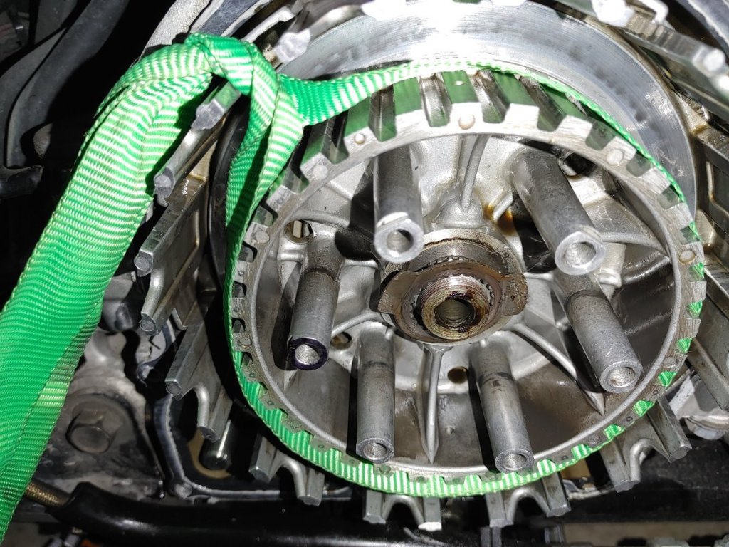

Good evening guys...If my thumbs worked, there should be 6 pictures attached to this msg. 2 quick points... 1- That oil pump idler was indeed the source of the yellow plastic bits in the case. Thanks for that, Carl. That idea of the timing chain blocks would have been a next place to look, Ben, but with the way that Idler is chewed up I think it was the source. 2- Puc..your suggestion of using a bike strap to hold the clutch drive was genius-level Use Whatcha Got thinking. Worked like a charm, and with less effort than I was expecting. I guess that center nut isn't really cranked on hard, given the lock washer holding it in place. As is clearly obvious in a couple of the pics...the missing ball bearings were the culprit as far as I can figure. They were obviously making all the noise while letting the basket move everywhere including in circles. A question or two here though. Is that 3-holed plate the only thing holding that bearing in place, or is it pressed onto the shaft as well? Is this something that can be removed from the outside ( meaning "by me"), or does the tranny need to be taken apart to get at the shaft...which of course means pulling the engine. Also, I can't find any reference pictures / diagrams in the Parts or Service PDFs that show that end of the shaft with the bearing and that hold-down plate. The way I'm reading the Parts pdf is that bearing is part # 93306-36401-00 attaching to the outboard end of the Main Axle which is closer to the front of the trans. One last issue...the elephant in the room as it were. The bearing is missing what looks to be about 6 balls. Since I didn't find any in the clutch area, and there is a fairly large opening below that area leading into the oil pan, I have to assume they are hopefully sitting at the bottom of the oil pan. I was able to fish some metallic bits out of both the clutch area and in the oil pan using a small magnet but the ball bearings might have rolled to the Down Side of the pan since the bike is over on the lean stand. According to the Service pdf, they say the engine has to come out to remove the pan and oil pump, but from what I could see, there is a dozen or so socket-head bolts holding the oil pan on and it looks like it would drop right out the bottom between the frame rails. I don't really want to try to coax the AWOL balls out of the oil drain hole, and they surely couldn't have disappeared. Believe me when I say...any input from those who have gone this route before is welcome. Once again, compadres...muchas gracias...Cheers
Thanks for that last bit of info @cowpuc...it addressed most of the questions I had...I'm sure more will pop up before long. I like that idea of using an old clutch "steel" as a hub lock. It just so happens I have a few steel plates from the clutch swap a while back, along with a buddy's Lincoln wire welder that he's in no hurry to get back. I might just give that a try, or possibly your strap grip method. Either way my 40 year old Craftsman Impact will be getting some exercise tonite. Don't worry about carryin' on with the replies..I was able to make sense of it and follow right along. Now I just have to transfer that "sense" to my hands and tools in the garage. 🤓 Cheers...
While I had the cover off, I was looking around the case beneath the clutch looking for more shrapnel and saw that plastic gear behind the clutch. It's where I suspected the piece was from, but on the part of the gear that I could see I there was no damage. I guess I could try bumping the motor on the starter to turn that gear, couldn't I? Sorry @cowpucand @Marcarl..I wasn't thinking that those pieces were engine related. I am truly hoping it's clutch or tranny, but my understanding from shop manual information is that the engine needs to be pulled to get at the trans. Naturally, I'm certainly hoping it's something I can get at from the outside. Regarding the basket removal. There is the lock washer and large nut to remove, but it looks like the clutch push rod..the short #1...has to come out first. Besides keeping track of that little ballbearing, should I be expecting that inner push rod to come flying out after pulling the small one? There seems to be a bit of outward pressure on that small rod and I'm wondering if I'm going to get a fluid bath once that first rod pops out. One more item that I just now saw looking at the parts manual (pdf). The exploded view shows a bearing (#93306-00304-00 or B6003C4) as being to the outside of the push rod , nut and lock washer..as in it comes out first, yet the service pdf makes no mention of that bearing, nor does it appear in any diagram of the clutch removal. Any thoughts? I have replaced the OEM clutch with a Barnett Spring & Pressure Plate Conversion, along with their fiber and steel discs The only bearing I can think of is the one in the center of the pressure plate, however I don't remember taking OUT a bearing from the OEM. Not saying I didn't...just don't remember. (geezer alert!!) I appreciate the info guys...both the hand-holding while I sob into my cold adult beverage, and the part # for that idler. I now have something to do this evening. I'll yank the clutch cover and take a shot at removing the basket to get eyes on what's back there. If I can figure out how to get pictures up here, I'll try to post a few. Visuals are usually more helpful than words.
