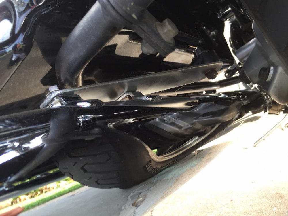

	Here she is in all her glory. I fabricated the straight mounts out of 1/8 flatbar. I removed and installed the shields from the OE exhaust for a more finished look. Love the sound.
