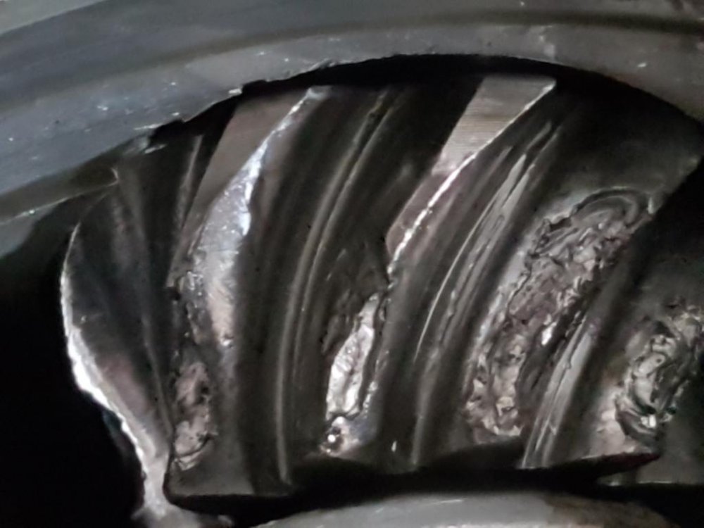

This is very dangerous, I would not recommend driving the bike. The final drive can and eventually will lock up and you will be thrown. My pinion gear, I was very lucky to make it back from my trip. -
