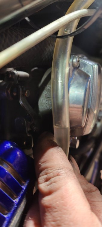

KoboldWrangler Posted March 28, 2025 Author Posted March 28, 2025 Ugh. Decided to wet check the carbs with them split. Only got one checked so far and it's 20mm below center, (14mm is stock). I made sure to tap on the carb and repeatedly prime the fuel pump to ensure the level is accurate. It's so weird cause the floats are set right at 28.5mm. this would explain why it's running lean I suppose. I'll get them reset and report back.
