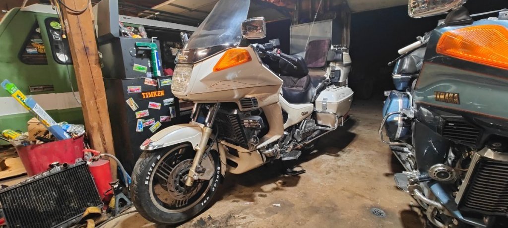

KoboldWrangler Posted October 25, 2024 Posted October 25, 2024 Hello-- Picked up this '88 1300, 109k miles. It had been sitting for about 6 years before I got it. I'm currently going through the motions of getting it road worthy again -- calipers, slave, carbs, etc and I am currently fighting the two right side carbs. Unfortunately there was gas left in the carbs, which goo'd up the lower quarter of them, but thankfully it wasnt too bad (unlike the 1200 i also picked up...). All the carbs received ~1hr ultrasonic bath individually consisting of hot water, dawn grease soap, and simple green max. Came out nice, used 100psi of air to blow out all the passage ways, replaced o rings, gaskets, diaphragms, and put them back together. There was only one pilot jet which I could not remove due to it stripping out. The rubber plugs are still snug in the jet blocks, but they are on my list of parts to change. I for the life of me cannot get the bike to consistently idle on the right two cylinders. Sometimes, not often, it will idle on all 4, but more often than not, the idle will be low, and you can pull the right two side plugs and the idle wont change. I've had the carbs apart multiple times, and cannot get a different result. When I pull plugs, they will audibly be snapping, and the one time i had a spare plug hooked up, it had a scarily bright blue spark. Plugs when pulled will also be wet. I will be replacing spark plug boots tomorrow as a maintenance item, and will report if anything changes with that. Is there something I am overlooking? Anything I should check? Also, is there an easy way to remove / drill out the stuck pilot jet?
