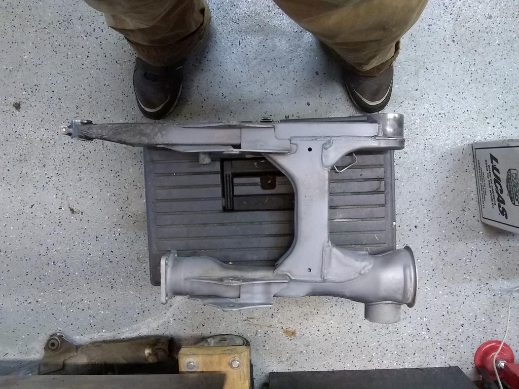

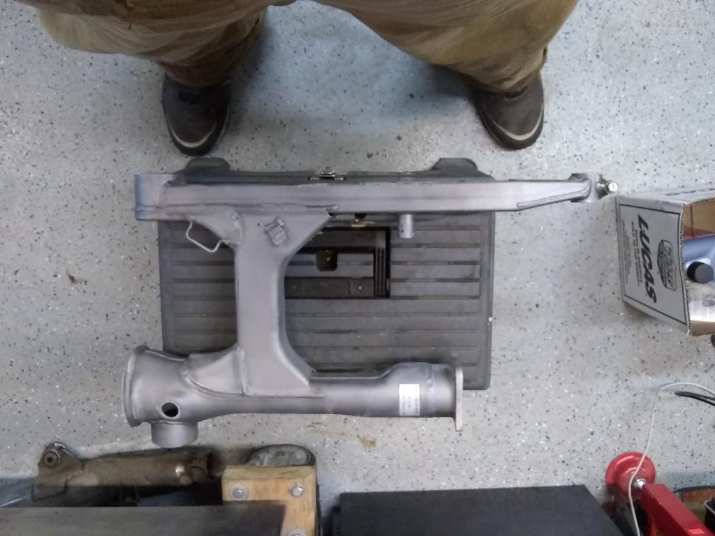

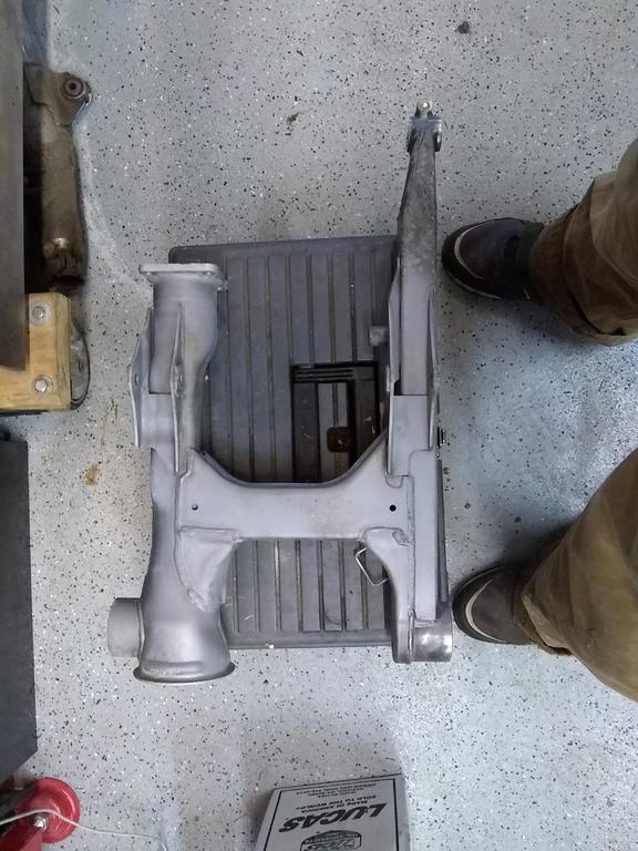

dna9656 Posted September 15, 2018 Author Share #15 Posted September 15, 2018 (edited) Well now that we're here in the Swing Arm, Final Drive Gear, Arm/Arm1 forward and to each side of the rear wheel area.... I got the Swing Arm, Arm 1 and the Relay Arm off the bike. I'm going to have to media blast it for paint as it hasn't much paint on it. Now to my concern, there is an arm of some name that links the shock to the Relay/Arm 1 assembly, I can't find it in the parts book so i cannot learn of it's proper nomenclature but in any event, apparently you have to remove the exhaust collector to get the bolt/pic out, well, screw that, I know better than to screw with used exhaust parts... So I did the best I could to lube that pin, I will pull the bearings out of the Swing Arm and media blast the Swing, Relay and Arm 1, prime and paint them and re-install the bearings/bushings unless i can pick them up new for very little (the bearing now in place don't seem to be bad) cost, there are oils seals as well.... Anyway that's what I got done this evening! So having removed the bearings in the Swing Arm... They are not pressed in but the races are... The bearings had what looked like enough grease for shipping purposes and that's all. Obviously they are not sealed bearings, only one side is a blind hole and the other (because of the drive shaft) is not. IMHO the should be sealed, a least the one on the drive shaft side should be. Edited September 15, 2018 by dna9656 Link to comment Share on other sites More sharing options...

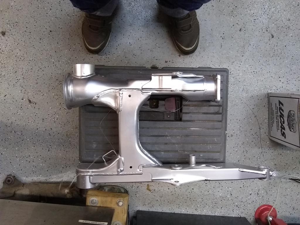

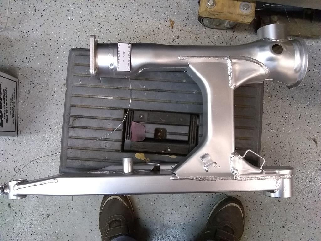

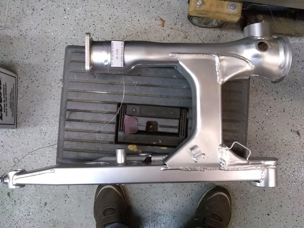

dna9656 Posted September 16, 2018 Author Share #21 Posted September 16, 2018 (edited) Anyone got a swing arm this clean? Off to get some self etching epoxy primer and some silver paint hopefully in epoxy as well. Edited September 18, 2018 by dna9656 Link to comment Share on other sites More sharing options...
