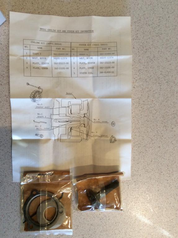

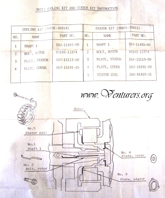

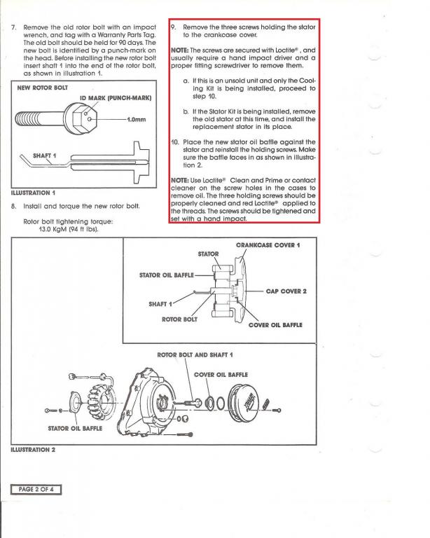

Prairiehammer Posted February 23, 2016 #2 Posted February 23, 2016 (edited) The plate you call "free floating" is the "cover oil baffle" and is not free floating. It should be captured between the crankcase cover and the "cap cover 2". See below: M84-025 Stator Cooling Kit Installation.pdfFetching info... Edited February 23, 2016 by Prairiehammer
Great White Posted February 23, 2016 Author #3 Posted February 23, 2016 Interesting. Mine does not capture....I can push it right down the bore to the crank bolt. Birth defect maybe. But if you look at the oil flow pattern in the second picture, it seems a spray hole in the flat of the bolt would achieve the same effect. Probably why the new crank bolt is drilled that way....

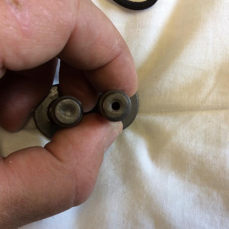

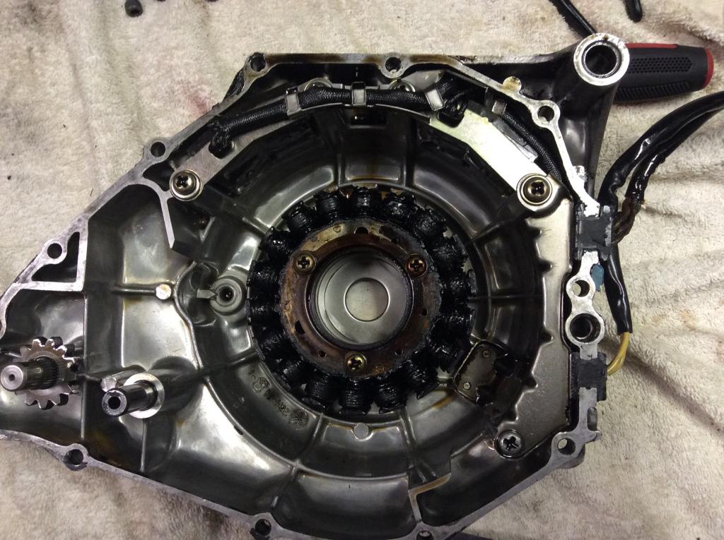

Kiwiroyale Posted February 24, 2016 #6 Posted February 24, 2016 FYI, A couple of pics showing what I installed, the cover plate can be seen in the pic with the old burnt out stator (note up turned flange facing "in"), the stator plate affiixed to the new "Ricks" stator, and the original and new "drilled" bolts.

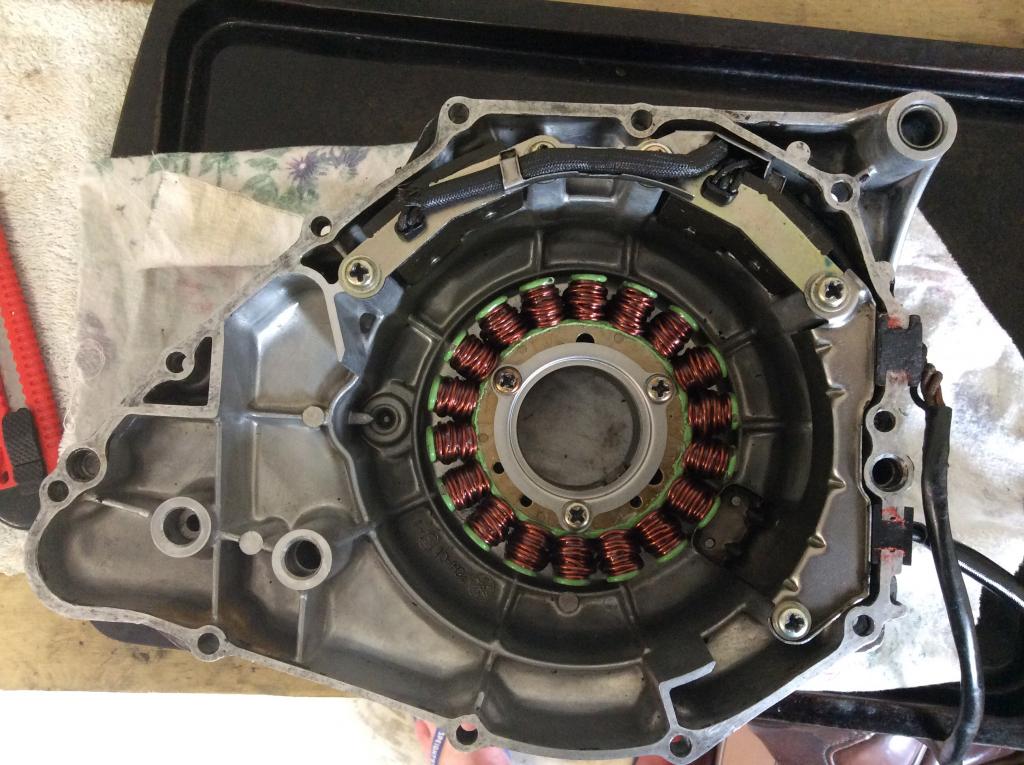

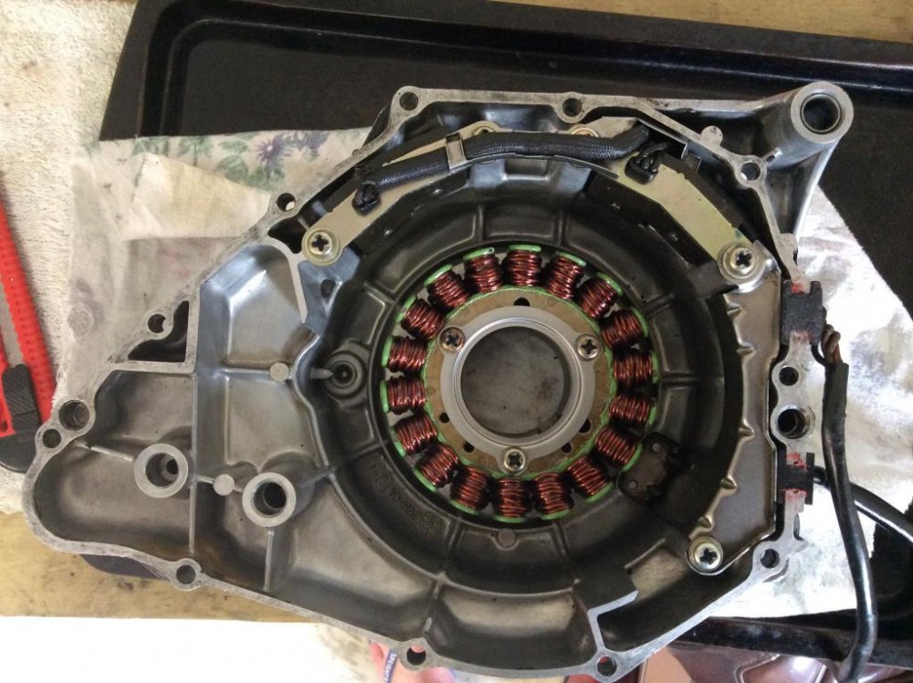

Great White Posted February 24, 2016 Author #7 Posted February 24, 2016 Well now, isn't this interesting: That's from a 2nd gen. Looks like it has both plates the same as the cooling kit on the 1st gen. Didn't see it in parts fiche. Worth another look methinks.......
