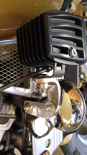

stanG Posted September 19, 2015 #32 Posted September 19, 2015 I recently upgraded to this bulb from the 2800lm bulb available from Canadian Cruiser. I never was real happy with the old bulb as it was great on low beam but didn't get out much farther when you put it on high beam. This one, on the other hand, is a significant improvement and gets out there even better than the Silverstar Ultra that I have also used. Nice bright white light and a good pattern. If you are thinking about LED this is a very good option at a reasonable cost. I bought mine directly from Opt-7 for 55 bucks with free shipping. Installation was simple plug and play as I had already had jumpered the CMU and reserve lighting unit. I also run a set of Rigid Dually floods mounted on some custom brackets at the horn location. Since I ride to work at 4:30am each day, this combo lights up the road real well. Here is a photo of the brackets I fabbed up of 1/4x1" aluminum then polished out.

lonestarmedic Posted September 21, 2015 Author #34 Posted September 21, 2015 stanG said: I recently upgraded to this bulb from the 2800lm bulb available from Canadian Cruiser. I never was real happy with the old bulb as it was great on low beam but didn't get out much farther when you put it on high beam. This one, on the other hand, is a significant improvement and gets out there even better than the Silverstar Ultra that I have also used. Nice bright white light and a good pattern. If you are thinking about LED this is a very good option at a reasonable cost. I bought mine directly from Opt-7 for 55 bucks with free shipping. Installation was simple plug and play as I had already had jumpered the CMU and reserve lighting unit. I also run a set of Rigid Dually floods mounted on some custom brackets at the horn location. Since I ride to work at 4:30am each day, this combo lights up the road real well. Here is a photo of the brackets I fabbed up of 1/4x1" aluminum then polished out. [ATTACH=CONFIG]101769[/ATTACH] stanG - I like your brackets. Simple and neat. As I run the Rigid Duallys we have the same lighting system. Mine inspires a lot of confidence in the dark backroads.
