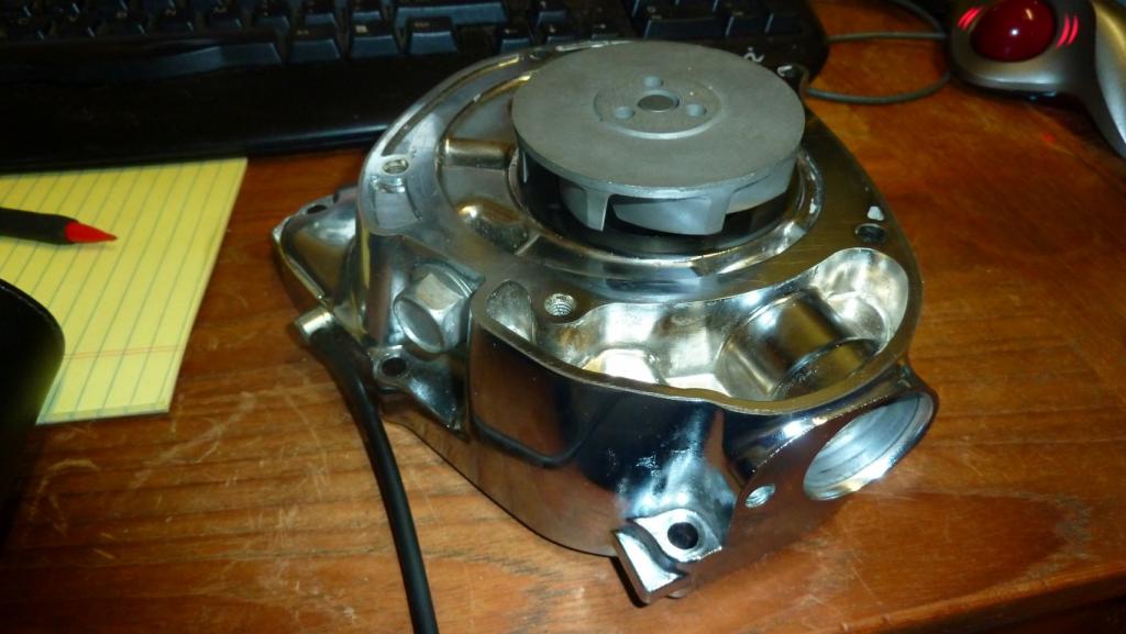

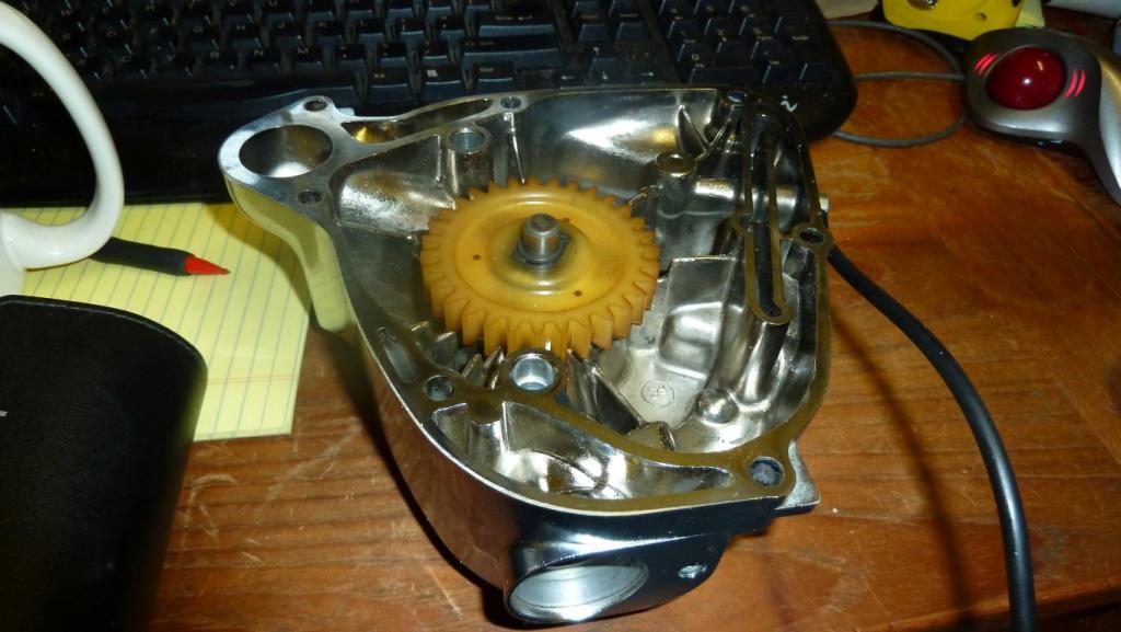

Condor Posted July 29, 2015 Author #28 Posted July 29, 2015 So the pumps finally off and apart. Getting that baby off was no easy chore. 'Specially the hex cap that holds the chrome tube. Getting back in there with an allen wrench was no fun. Now the fun part. I must have a half dozen drift punches to get the bearing out. Do you think I could locate just one. Lesson learned... Never loan you tools to your grandson... Off to HF this morning to buy another set. I even own a bearing puller. Couldn't find that either... Also when I finally checked the seals it looks like the oil seal had been installed backwards and just pulled out of the housing. So at this point I'm going to pick up another bearing. Might as well since I'm into it this far... Stay tuned....
Condor Posted July 30, 2015 Author #29 Posted July 30, 2015 (edited) Found a punch yesterday morning, and was able to drive the bearing and oil seal out of the housing and rebuild the pump body. No I didn't replace the bearing. After inspecting I couldn't find anything wrong with it. So it went back in. It had to come out to drive the seal housing out of the casting. Things are a lot tighter and the circular looseness is hardly noticeable, and it's a lot more solid feeling. Also able to remove all of the silicon off the cover side. I did find flakes of silicone in the passages. Hope they come out with the flush... Things are moving along. Time to get to the thermostat... Edited July 30, 2015 by Condor
