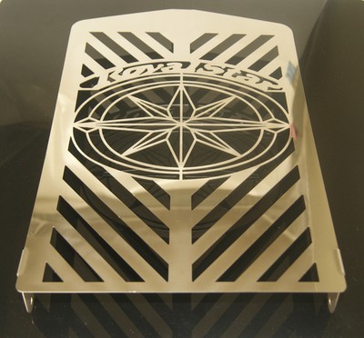

YamahaLarry Posted June 29, 2015 Posted June 29, 2015 Installed one last year and to make it a little easier, I made a cut out in one side of the top hole to make it more of a hook than a hole for easier installation. Best I recall, it was 1/2 hr to 45 minute job for the entire process. This is the version that I have.
StarFan Posted June 30, 2015 Posted June 30, 2015 Installed one last year and to make it a little easier, I made a cut out in one side of the top hole to make it more of a hook than a hole for easier installation. Best I recall, it was 1/2 hr to 45 minute job for the entire process. This is the version that I have. Taking a shortcut this can of cause be installed in 30 minutes. Going all the way without making alterations I will stick to my 90 minutes. In either bike was I able to pull the radiator down far enough to get the top hole over the top of the radiator without unhooking the hoses. If there is a way to do it then I would really like to know since I will most likely have to do this again sometime and would really like to be able to do it easier/faster than before. Still, when putting the cover on it is a good idea to just go all the way, remove the radiator, flush it and change the fluid if it is due.
