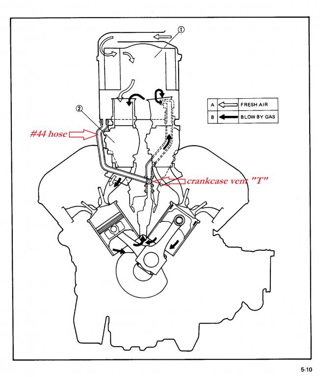

Where the pipe No. 44 is connected? From above only carburetors...
[ATTACH=CONFIG]99486[/ATTACH]

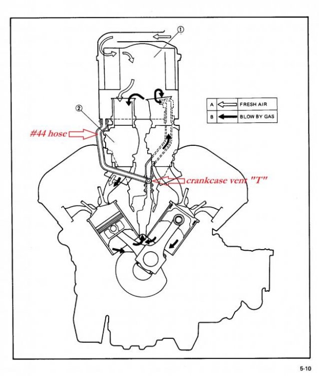

Number 44 tube goes from the left front corner of the airbox (drain for accumulated oil in airbox) to the "T" in the crankcase vent hose.
Connected between #32 (in the joint of the cooling system under the right side cover, 3 hoses together there on same joint) and cover # 37 which lays between the 2 cylinder banks.
You described #49 hose layout. He asked about #44 hose.
