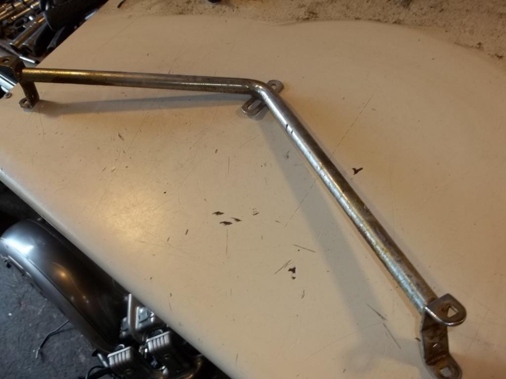

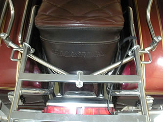

Prairiehammer Posted May 27, 2015 Share #3 Posted May 27, 2015 Some time ago, I purchased a passenger armrest on eBay. The seller claimed it was off a 1987 Venture. When I received it, I could not for the life of me, figure out how it was mounted on a MKII. As I researched the possibilities, I came to the realization that the armrest was originally intended for a mid-eighties Goldwing. The PO had removed the two tabs that would have clamped the armrest (via U-bolts) to a bar on the Goldwing. I put the armrest on the shelf and continued my search for passenger armrests intended for the Venture. Never did find any. Jim Crane @Jayceesfolly asked on this forum about wanting armrests and I gave those Goldwing armrests to him. He was going to cut and weld the brackets to fit the Venture. Subsequent to sending the armrests to Jim, I discovered a write-up in which a Venturer member had modified the exact same Goldwing armrests to fit his Venture. I sent that document to Jim. Below is the Goldwing bracket that I had, and a pic of unmodified Goldwing bracket. And below is the mod in .pdf format. Good luck! armrests from Gold Wing.pdf Link to comment Share on other sites More sharing options...

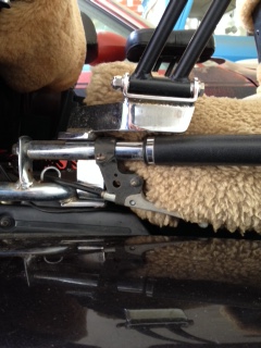

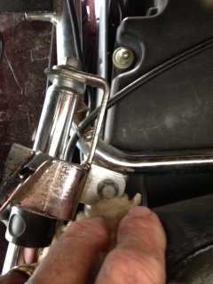

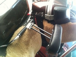

jdross440 Posted May 27, 2015 Share #4 Posted May 27, 2015 I have some on my 90. I only have one picture of the right side one but can take more. Link to comment Share on other sites More sharing options...

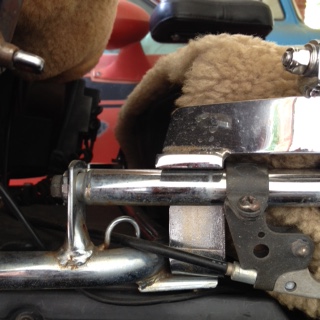

jdross440 Posted June 2, 2015 Share #6 Posted June 2, 2015 I finally got to take more pictures of how the armrests are mounted. Link to comment Share on other sites More sharing options...
