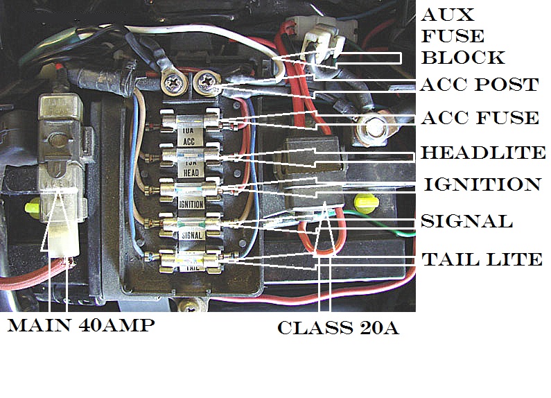

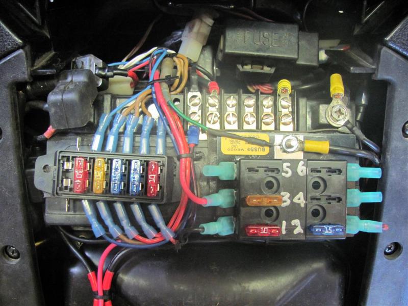

Prairiehammer Posted February 16, 2015 Posted February 16, 2015 Attached find an annotated pic of the stock First Gen Venture Royale (please don't call it a "RSV") showing the fuse block as from the factory. Also attached is a pic of my refurbished fuse block. Note at the top of the pic the black plastic box emblazoned with "FUSE". This stock fuse block has four ATC fuses in it (audio backup, audio CB, fan, hazard). Your schematic has combined the five glass fuse block and the four ATC fuse block into one nine fuse block. As you can see, that is not how it actually is. I will recommend that before you spend much more time on this bike's electrical gremlins, that you upgrade the fuse block. Once you have that upgraded, then subsequent problems will be narrowed down to discrete connections and/or switches.
Vonwolf Posted February 17, 2015 Author Posted February 17, 2015 Thanks for the Picture Kevin, mine looks somewhat like yours only no labels. heavy corrosion, fuses too long/short and nowhere as neat as yours. The labels are a huge help, it takes a lot of guesswork out of things. I do have to replace this fusebox with something, there's no doubt it's the source of manny of my intermittent power loss issues, so I agree it's best to do this sooner rather than later. I can see that the 2 screws are fed by the 10A ACC fuse but that's the one fuse I can't get power to. it looks like it's fed off the main switch so I have a place to start at least. I'm starting to make some sense out of the wiring. butI still have that nagging starter issue. mabee some other day

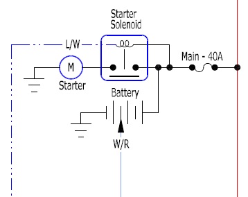

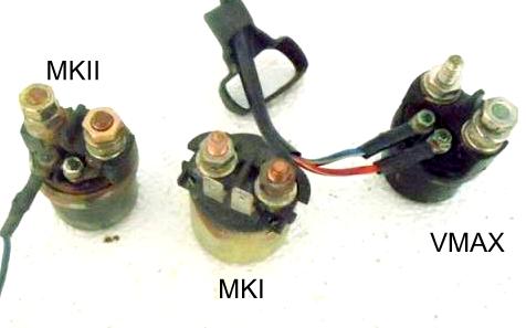

Vonwolf Posted February 18, 2015 Author Posted February 18, 2015 That is true, IF the Starting Circuit Cut-Off Relay coil is energized. The SCCR coil is energized through the IGNITION fuse (Brown input, Red/White output) and then through the kill switch. Do you have battery voltage after the IGNITION fuse on the Red/White wire? I'm going to have to check the voltage, but I before I let it sit al those years I just bypassed all the starter switch and ran a 12v 12ga jumper to the + side of the solenoid directly to the + Battery terminal, if it didn't start right off then the wires melted. Now I can't remember what the correct way to wire up the solenoid, does anyone have a picture of the top of a solenoid it might jar some rocks loose in my brain
Prairiehammer Posted February 18, 2015 Posted February 18, 2015 I'm going to have to check the voltage, but I before I let it sit al those years I just bypassed all the starter switch and ran a 12v 12ga jumper to the + side of the solenoid directly to the + Battery terminal, if it didn't start right off then the wires melted. Now I can't remember what the correct way to wire up the solenoid, does anyone have a picture of the top of a solenoid it might jar some rocks loose in my brain
