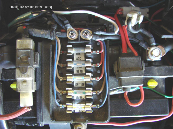

Pictures are worth 1000 words. Anyone feel like taking pics of the main fuse and location? I know Mike checked all the fuses in the block 3 times now to verify them. Mike was really hoping to finally take me on that b-day ride I missed last month.
Well, I changed out the main fuse, but now there's a new problem. When I hit the start button it starts making a nose like "clug clug clug clug clug" and if I turn the handle it seems to scream out "mmooOOOOOOOVVVVvvvve.... MOOOOOOOOOOOVVVvvve!"
