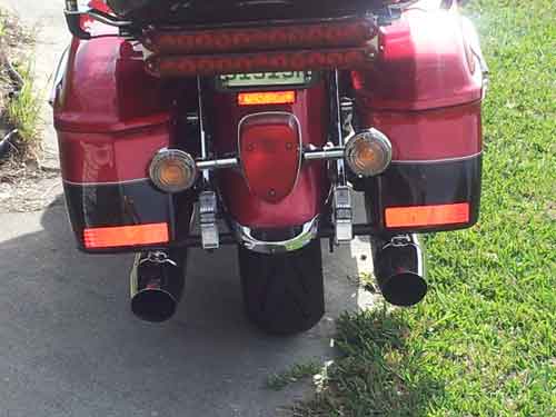

VentureFar Posted April 25, 2013 #32 Posted April 25, 2013 2007 RSV - Added the 16 LED Hyper-lites up high like I said. I bent some corner braces and spray painted them gloss black. Bent them a few times and mounted them under the rear cargo rack posts. You can see them clearly mounted here http://img.photobucket.com/albums/v468/ihavethespirit/4ee784f2-445f-4855-8729-74bc122e99d0.jpg This is just running lite position. Brake lite is so much brighter. http://img.photobucket.com/albums/v468/ihavethespirit/hyperlitesrunninglightsmall1.jpg What I like is that I have light UP HIGH at eye level for a driver- maybe it will catch their attention away from texting far enough back to stop! OH - almost forgot the shameless plug for M61A1MECH's harness for quick wiring the tail lights - he makes it so easy it is dumb to work the wires yourself !
VentureFar Posted April 26, 2013 #33 Posted April 26, 2013 Got the 100 LED Board in the mail today. Installed it in about 2 minutes and it is definitely brighter than the bulb. I would guess 30-40 %. Not as bright as the hyperlites in running mode but when I hit the brake it is like HELLO ! RED IN YOUR FACE !!! I recommend the 100 LED board for more rear light and for a whole lot more rear light get the 16 led Hyperlites. VentureFar...

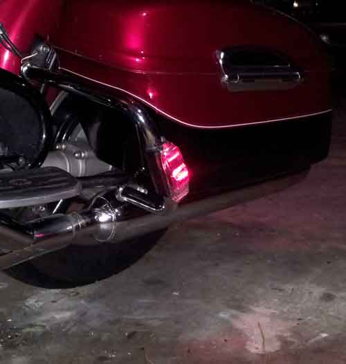

djh3 Posted May 13, 2013 #38 Posted May 13, 2013 Grr I hate scotch loks. But sometimes ya just have to use them. I bought some LED marker lights. They had the clear lenses but show red for the rears and amber for up front. I took the OEM reflectors off (front and rear) and mount the lights. I built a couple of brackets for the very back by the bags. Made circuits so lights are on for run and also flash for turns.
