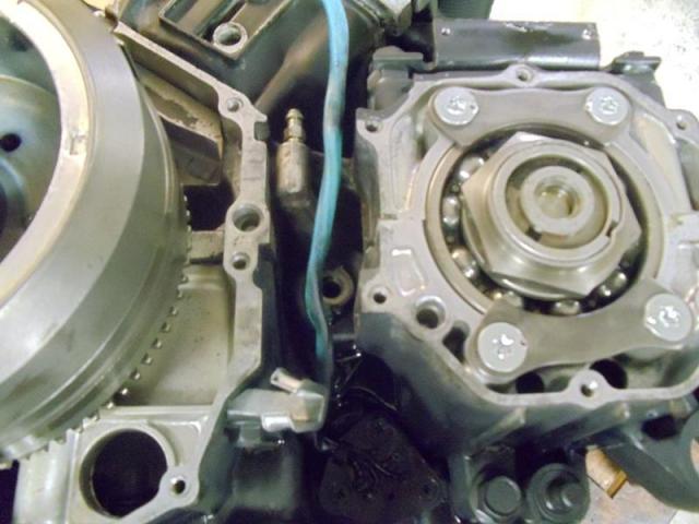

dingy Posted April 25, 2012 #4 Posted April 25, 2012 The picture attached shows the bleeder screw with the stator cover & middle drive covers removed. It follows a path where the blue cable is running. Rubber flap is situated just above the bleeder screw to the left of the cover. This central 'shaft' is not sealed at all. The rubber flap is just a dust cover. Gary
