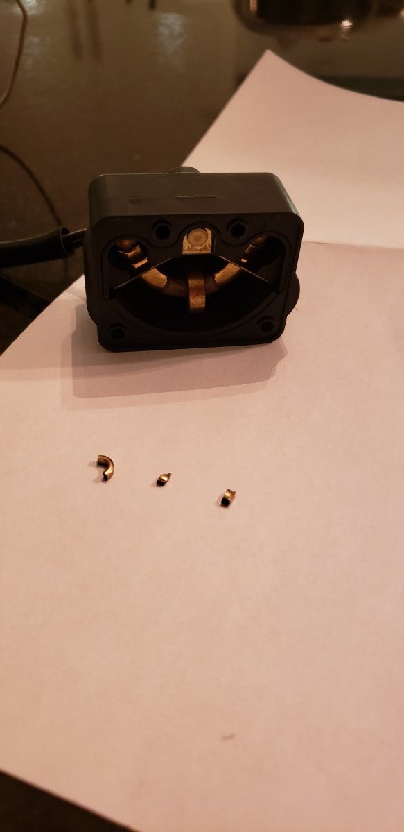

Poppa Posted October 10, 2021 Author Share #10 Posted October 10, 2021 On 10/5/2021 at 11:52 PM, videoarizona said: I had the same problem. Found two contacts on the ignition switch that were not connecting. One wire was broken. I have the ignition bypass as well.... The link above takes you to the two wires that were not connecting together in the ignition switch. The same two wires mentioned earlier blue/yellow, blue/black. In the ignition switch run position, those two wires are shorted/connected together.... This enables the coils to fire. You can easily check this by disconnecting the connectors that come from the ignition switch and use a meter looking for continuity between wire sets using the schematics for guidance. @videoarizona Dave, Thanks for the link, I read that post when I was searching earlier, and many more, lol. I have narrowed it down to a flaky bank angle sensor. I am getting resistance reading all over the map, from open to over 400 ohms. Ordered a new one. I will see if that keeps it running for more than 10 minutes. Looking at where it is located I am not looking forward to the job. I will let you know how it works out. We are running out of riding weather up here. Paul 2 Link to comment Share on other sites More sharing options...
Poppa Posted October 13, 2021 Author Share #11 Posted October 13, 2021 Quick update. Managed to remove the bank angle sensor from it's perch high up in the gooseneck of the frame. Carefully opened it up to see why I might be getting the erratic resistance readings. 3 small brass pieces fell out. I am hoping this was the cause of all my grief this past month. I will compare the ohm readings with the new switch when it arrives later this week. 2 Link to comment Share on other sites More sharing options...
videoarizona Posted February 25, 2022 Share #12 Posted February 25, 2022 (edited) That's interesting. Wouldn't think there would be any way for things to break in that box...... Edited February 25, 2022 by videoarizona Sp Link to comment Share on other sites More sharing options...
