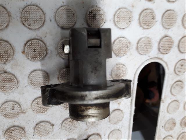

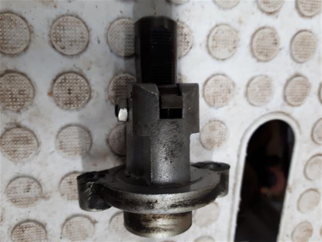

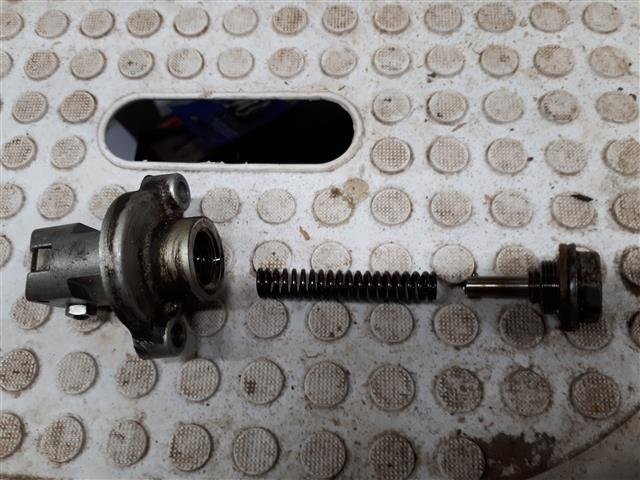

saddlebum 1,525 Posted November 21, 2020 Share #3 Posted November 21, 2020 Link to post Share on other sites
BlueChips84 18 Posted November 21, 2020 Author Share #4 Posted November 21, 2020 Already had both of those out, still had the chain taught but figured it out. probably caused the initial problem though before I removed the rearmost one. Link to post Share on other sites
