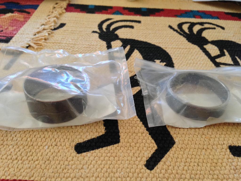

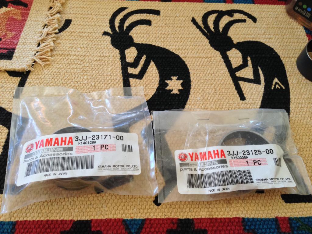

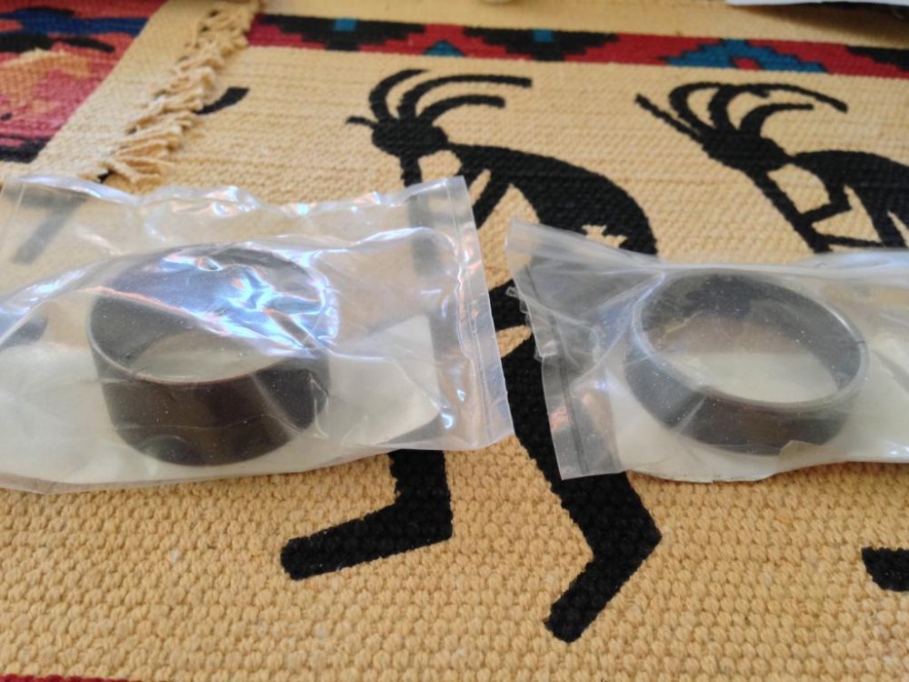

On the three sets I've taken apart there was another bushing, although it's called a piston. It's not on the '83 diagrams but it is on '84 and up. It's # 36-73 on the '84 diagram. I ordered those also, we'll see when the parts arrive if it's actually that bottom bushing. I'll let you know.
