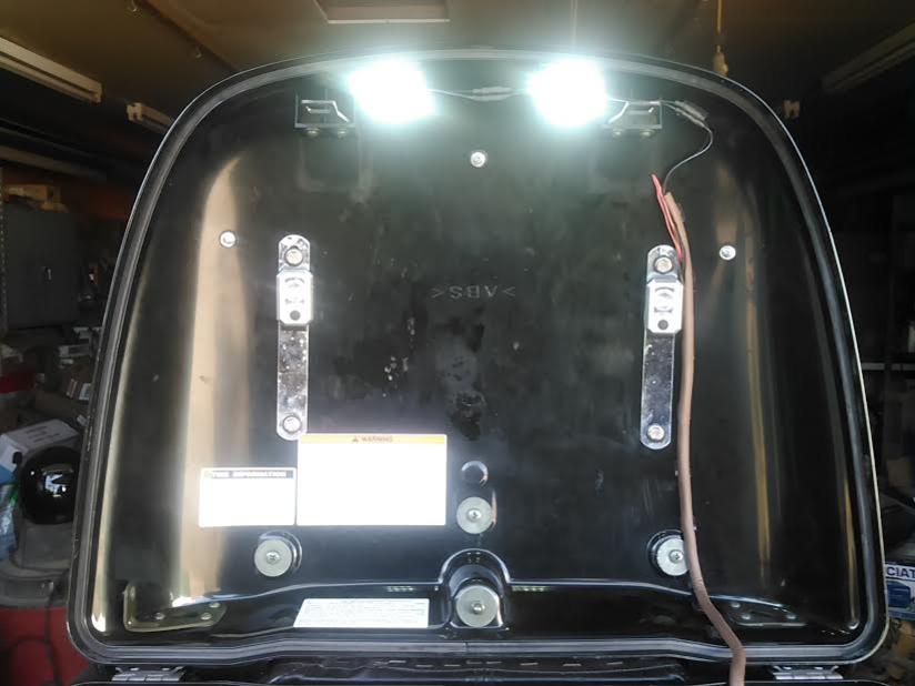

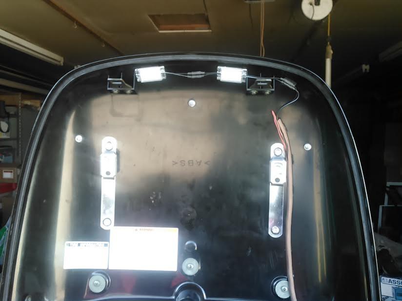

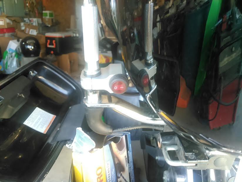

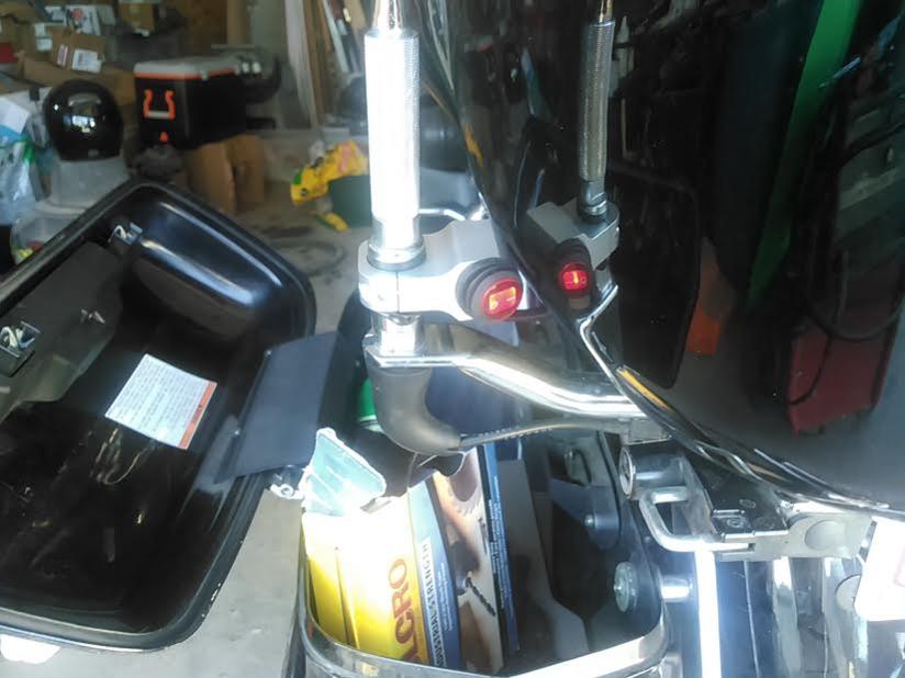

Installed a couple of really bright LED fixtures into the trunk lid today. Really lights it up and we should be able to find things in the dark now: Lighted switch on the CB antenna. I had to drill and tap two 4mm stainless set screws into the housing to keep it from rotating when the button was depressed. Reattached the flexible conduit using industrial "Velco" pads as the adhesive will take the heat without releasing. May wind up replacing this fragile foam thing with something more durable. Now my wife should be able to locate whatever she stows away. I have battery operated LED fixtures for the saddlebags as not really wanting to bore any holes in them. Rob
