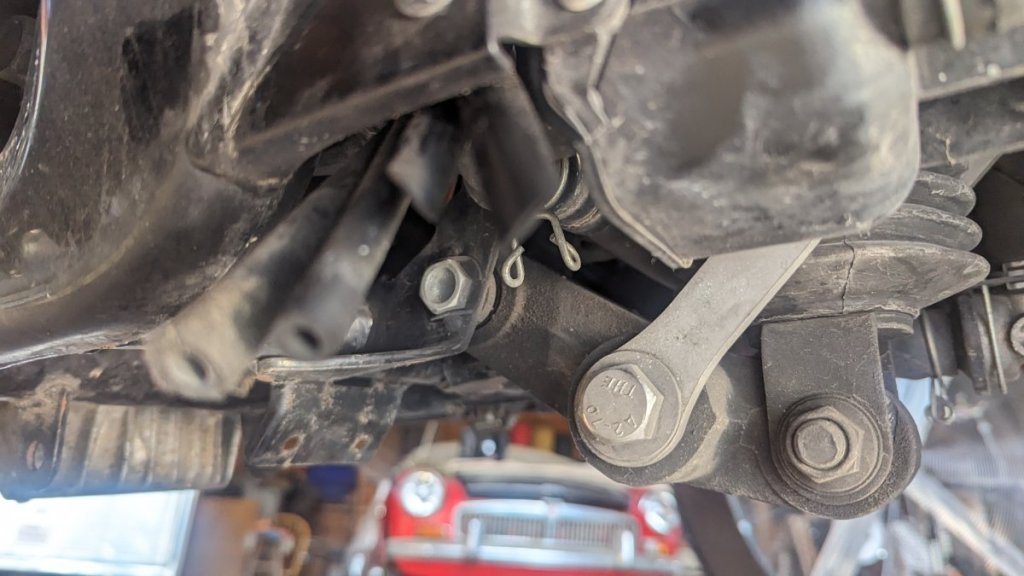

Thanks for checking. I'll probably leave it as is for now and then look into either replacing or repairing it this winter. Thanks again!

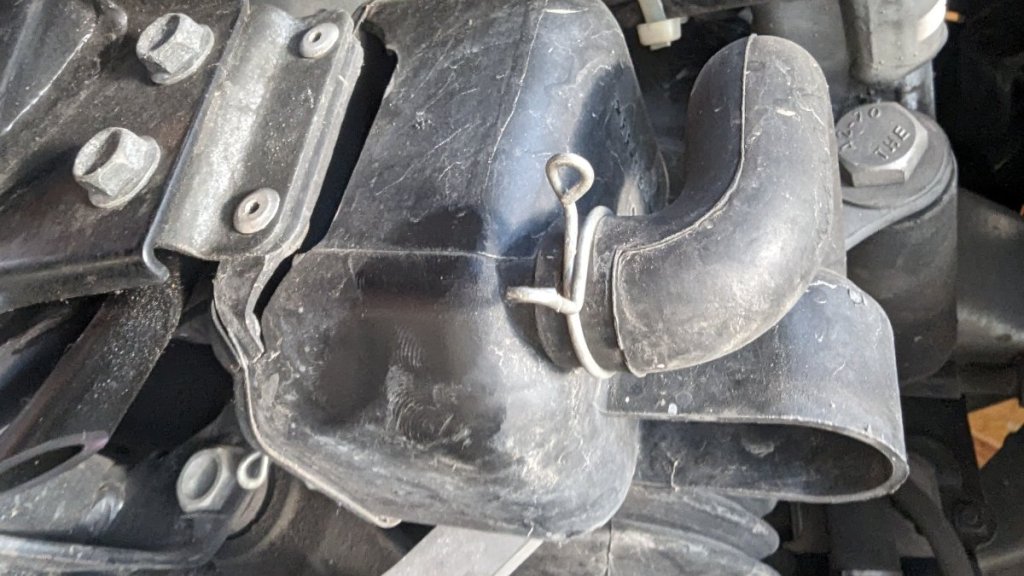

#22 looks like it! How urgent is this to replace or can it wait until I put her up for the winter?
Thank you! That eases my mind quite a bit! Now to figure out that plastic thing!
And on re-reading, I realize I neglected to say location. This is kickstand side, towards rear tire, behind exhaust, almost directly below passenger floorboard.
I noticed a very small what appears to be oil spot on the concrete under the bike on inspection, it appears to have seeped out of one of these tubes. So first, what are these and should I be concerned? Second, when looking at the tubes, I found this plastic thingamabob is cracked. What is it and should I be concerned? As always, thanks in advance.
