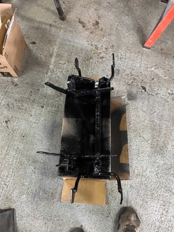

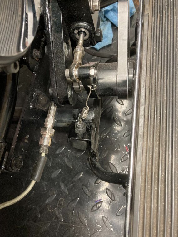

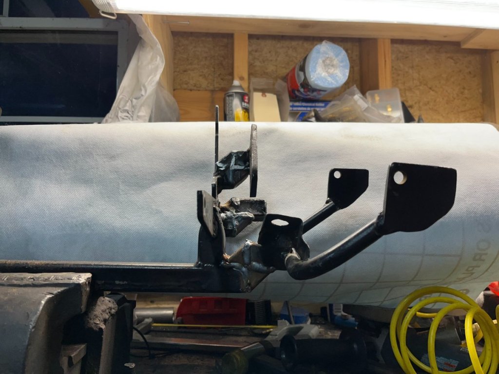

  1. Hi All How is everyone doing this Summer, down in Eastern Canada we are having Record hi temps, Mid to high 30's degree Celsius with Humidex that is between 90 - 108 degrees F. I figured I would give an update on the Venture Max HD, Unfortunately I have not been riding the bike yet this year however I have spent sometime working on the finishing touches. Over the winter I had purchased a Barnett Clutch kit , new Steels and frictions the old clutch was burned bad, I swapped that in May. I also purchased an aftermarket Signal Light controller (a direct Replacement for HD). Added Saddleman Gel inserts in the seat. Cut the Forward Controls Bracket and Raised the Floorboards a full Inch but now have an issue with the Shifter Linkage so still sorting that out, Rear Brake is Fine. I contacted Sean Morley and purchased the Ignitech Ignition Module flashed with the Latest Vmax Tune to match the Heads and Camshafts I Installed last year, I immediately heard the difference in the Engine and Throttle response. I also started experimenting with the Jet kits I ordered thru the winter and Now have the Carb adjustment where the Mixture and Idle screws are meant to be, according to the VW Carb guys, so far, I have dropped the Pilot Jet 2 steps from 55 to 45 and have increased the Main Jet 2 steps from 127.5 to 132.5., I also increased the adjustment on the Throttle pump but may adjust it more as recommended by Gary Hedberg of Venture owners on Facebook. Next step is to fix the Shifter linkage and change the Fork seals and hopefully put some miles on it. I also have a local motorcycle performance shop that does Dyno testing and carb tuning so I may look at retaining their services to fine tune the carb further once I have it dialed in i will provide the final settings and jet sizes. Enjoy the open road Herman K

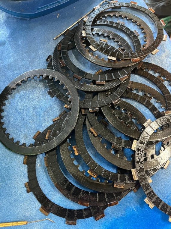

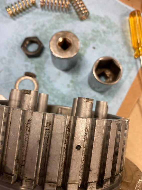

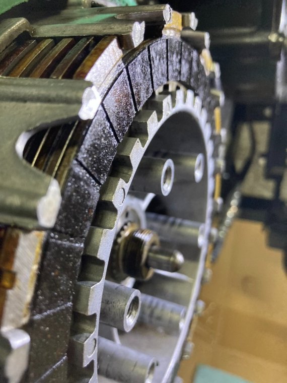

  8. Hi Everyone So I pulled off the clutch cover today to try and sort the issue with my Clutch slipping. here is what i found. When I put the Engine together I looked at the 2 Clutches Boss that hold the Clutch steels, the part number stamped on both was exactly the same 26H00S01. so I did not look any closer to them at the time and figured i was good to use the 1300 Boss with the 1200 Pressure plate. Obviously I probably did not put them side by side until now, so as you can see the Clutch Bolt Standoffs are flush with the 1200 Boss whereas the 1300 Boss these same Bolt standoffs are extended about 10mm past the Boss. as you can see in the pictures. Completely My fault, but it should be good now as I feel more pressure on the Clutch lever now. I also rechecked all thicknesses of the frictions and the Steels, the frictions all measure 3 MM and all the steels are roughly 2 -2.2 mm and the Factory Dimples are all still there, so I should be good. Test drive again tomorrow Herman

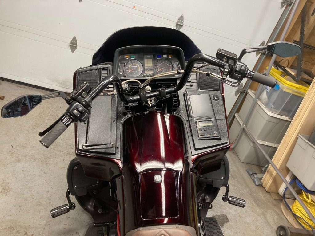

  10. Hi Everyone I finally had the Bike out for its maiden voyage today, the bike is a dream to ride, very responsive and very comfortable with the new Handlebars and Forward controls. Only issues I had was I almost lost my Shifter Linkage, It had loosened off and was literally on the last couple of threads on the shifter Side so it appears I forgot to Tighten the 2 Jam nuts or did not tighten them enough, I am glad I Had brought a few tools with me. The second issue is a slipping clutch, which I am bit shocked as I had upgraded the 6 springs to the Recommended Harley springs as well as replacing the 1/2 disc with a full disc, one thing to note is most of you who have updated their clutch by replacing the 1/2 disc commented that the clutch was a bit stiffer to pull I do not feel this is the case with my Clutch so maybe I missed something during the re-assembly. I had not replaced any Frictions or steels but did verify the Thickness with my caliper and they were all at the upper Thickness so I figured they were good, I had soaked the Frictions in Oil overnight before re-assembly, My only other Thought was maybe I should Have ran Dino Oil for the first Oil Change instead of T5 Rotella which Semi Synthetic. Upon arriving Home from the 100Km run I did get a low oil Indication, would this have caused the Clutch slippage? I had checked the oil before leaving and was 1/2 way between the marks as recommended but had to add a little more than 1/2 a Litre to get it back to the 1/2 way between the marks, there are no Oil leaks so I can only assume the few times running the engine on the Lift was not enough to fully fill the oil Passages and filter. The engine Likely has not run in 15 years and I did pull it apart to replace all the Seals and gaskets. I am on vacation for the next couple weeks and heading to Laconia on The 15th so I will be out riding over the next couple days to work out any kinks and to do some Final adjustments on the Single Carb so hopefully the Low Oil was the cause of my Clutch slipping. worst case I pull the Clutch Cover to re-confirm the Clutch configuration. Any Thoughts let me know Thanks Good Nite Herman

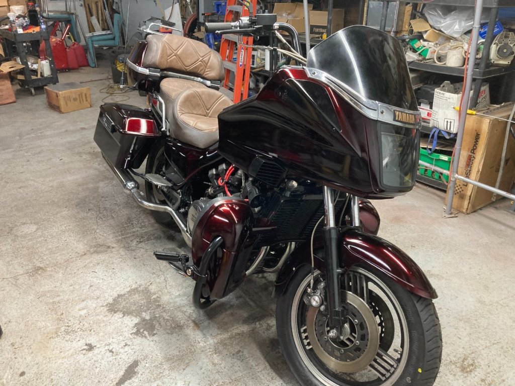

  12. Thanks Ben, Now I just need to take it out for a Ride. We are getting steady rain all this week for the forecast But supposed to clear on the weekend. I still need to put the Badging back on but will do a wet sand first then mount the badging then polish and wax. One question you maybe able to answer the 1300 came out of a 87 so it has not run for probably 8-10 years, I had it all apart but did not pull the Transmission or split the main case. Just Running the Engine and testing the clutch it seems to Shift Fine but have a hard time finding Neutral, I am hoping once I get it out on the road It will free up after getting the Oil circulating thru the Gears of the tranny. Herman

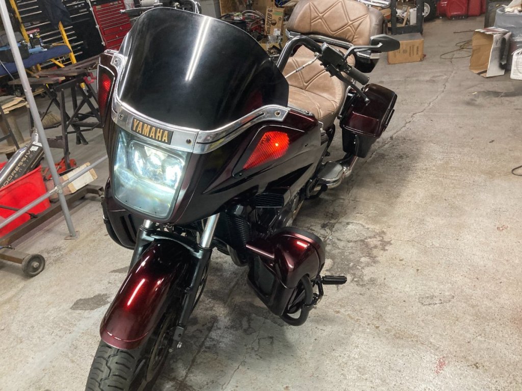

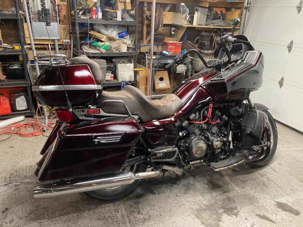

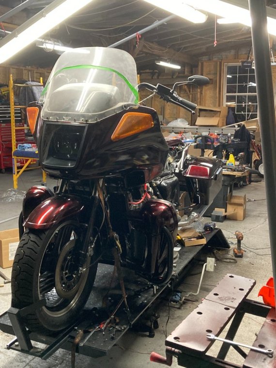

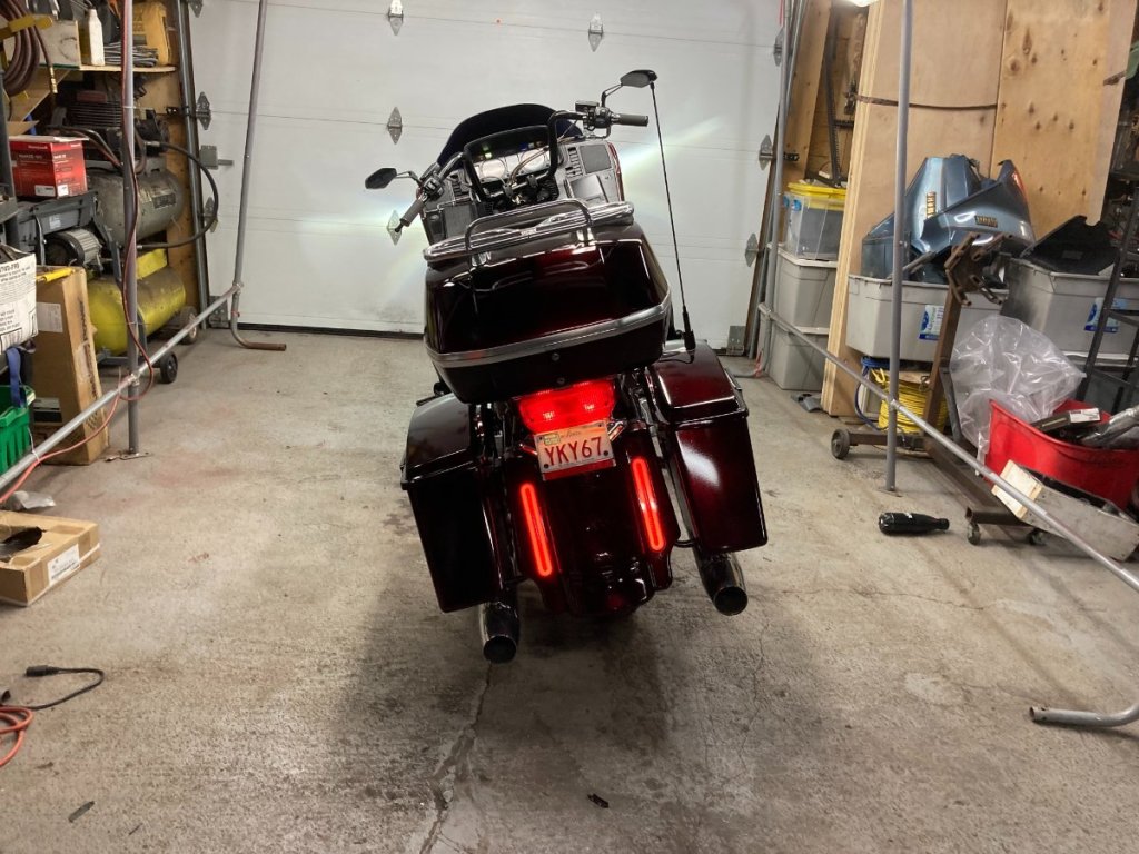

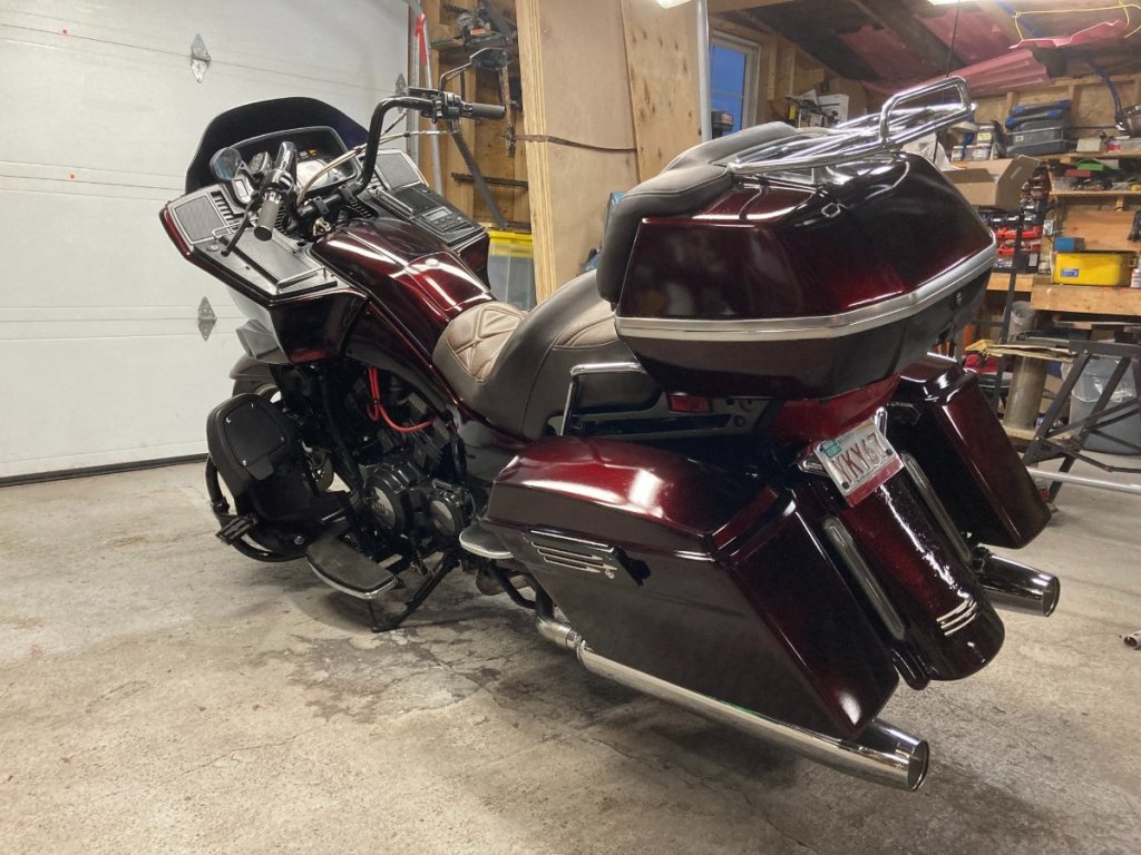

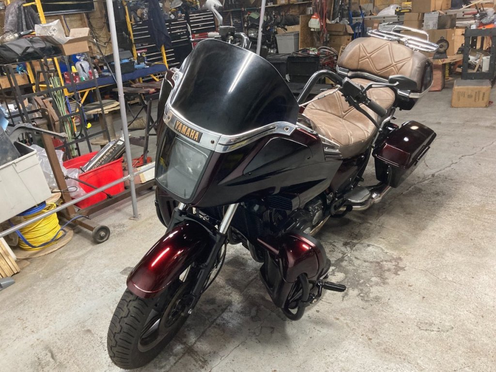

  13. Hi Everyone I am pleased to announce the Venture Max HD is now complete and off the Lift, now I just some good weather to take it out on its maiden Voyage, and put a few Kms on the bike before heading to Laconia in the 15th. Here it is fully assembled and ready for the road. I have also added some photos of the Blacked out Signal lights and the rear Lights. Thanks for all your Support thru out this process I will update the post after I have my maiden Voyage. Thanks Herman

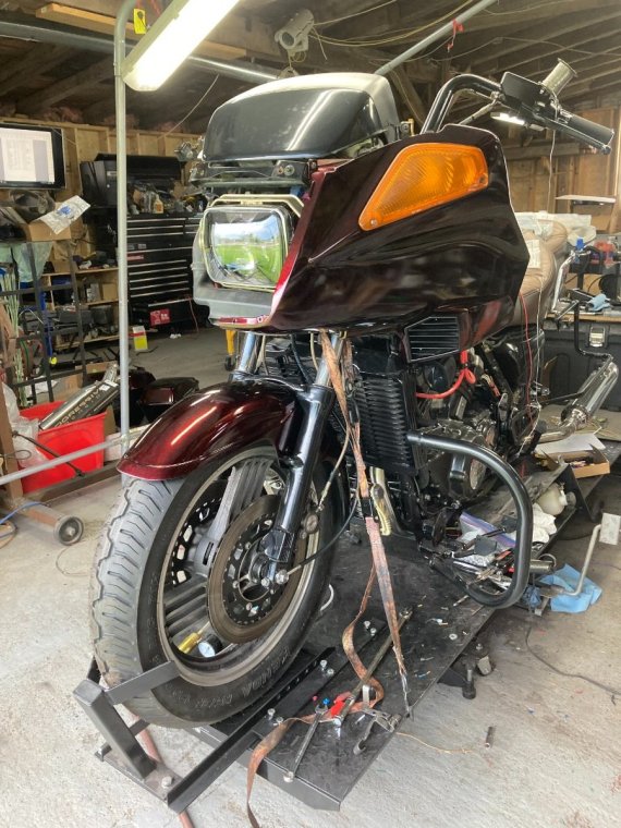

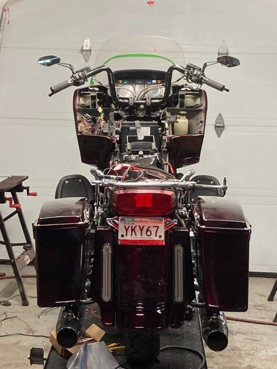

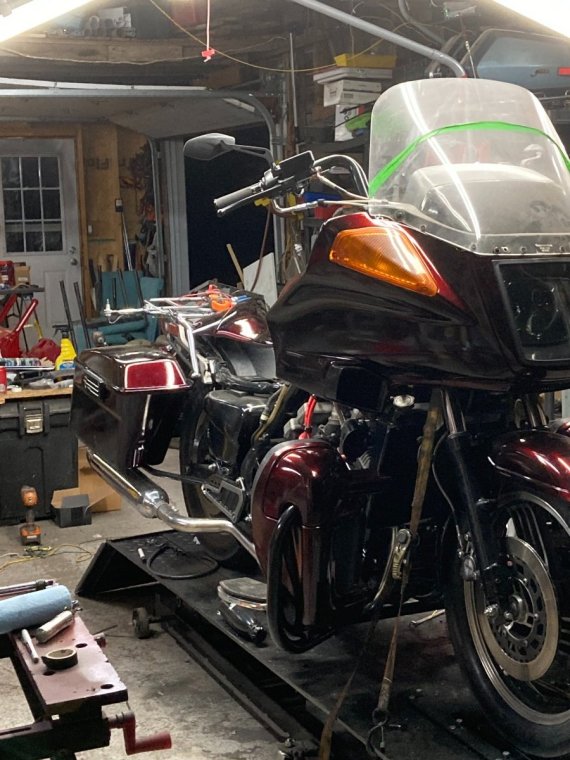

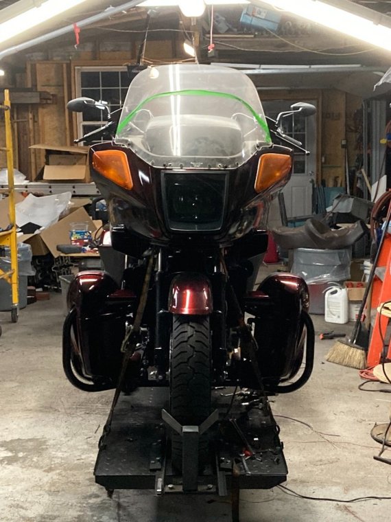

  14. Hi Everyone Made more progress on Tuesday Nite and the bike is really coming together. We installed the lower fairings to complete the front end, then went to work on the rear, installing the rear fender and the new Rear filler panel between the HD saddlebags including new LED Lights for Park/Brake/ signal. Also installed the saddlebags. Thursday evening I finalized where I was going to cut down the windshield and Cut it and finished the edge then Polished both sides with 5000Grit wet sanding. Also removed the Front Signal Lights then sprayed these and the inside of the Windshield with Black candy paint. Back out in the garage after supper tonight to Wet sand the Lights and Windshield and applied a second coat of Black Candy, I will spray the clear tomorrow on both sides of the windshield and the lights, also sprayed some gloss black on the inside of the Trunk to freshen it all up. A couple photos to show the progress. Shifter Linkage and Fairing dash pieces tomorrow, finish wiring up the rear lights and final adjustments to the Trunk mounting, also Mount the windshield and re-install the Lights. Have a good nite Herman

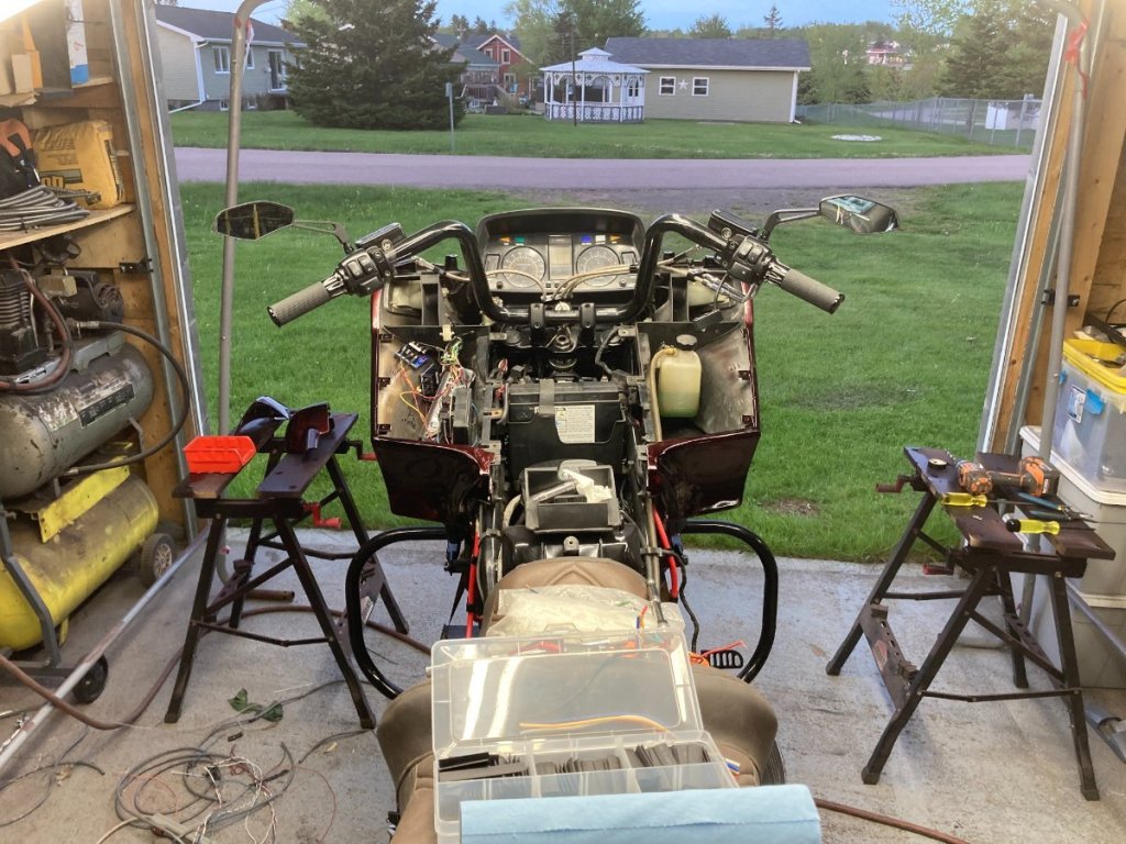

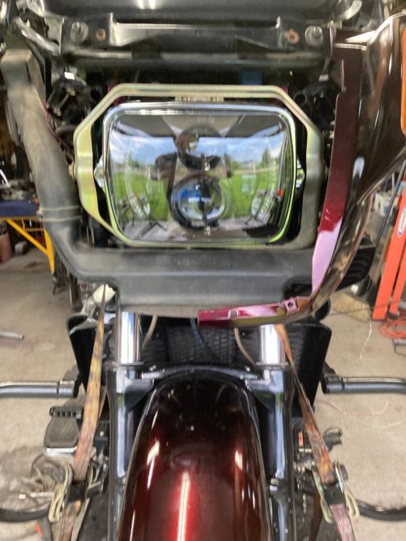

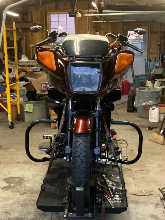

  15. Hi Everyone It is starting to look whole again, My Buddy Brian was over on Saturday to assist with the Brake bleeding as well as the clutch, all is bled and functional and no leaks. We also did the final adjustment of the Handlebars. I completed all the wiring and built a mount for the Rear Brake switch for the new Forward control brake peddle, while Brian re-assembled the Jigsaw puzzle of the Trunk and the saddlebags . After Brian left I continued to Work on getting the Fairing installed and the Front Fender, my LED headlight was covered in minor scratches from being moved around the shop so I gave it a wet sand with 5000 then sprayed on some gloss clear. After getting the fairing done the Signal Lights were sticking out like sore thumbs, I temporarily covered these with some Limo Black Tint (too dark) so I am gonna spray some Black Candy since it goes on transparent this way I can control the Tint level The Lights are still fairly Bright even with the heavy Limo tint so somewhere in between should suffice just to blend them in with the Black Cherry. Brian and I are set to work at the Bike tomorrow after work, so we should be able get the rest of the Bike together and knock a few more items off the completion List. More pictures and updates as I work at this project Good Night all Herman
