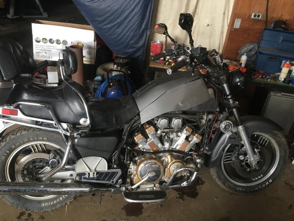

Got a bit more done on bike today no time for sizing photos but not much to see anyway, finished welding exhaust, wrapped the exhaust (I ended up using boiler/tubing wrap from work as the exhaust wrap I ordered wasn’t near enough to do the bike). The draw back is it’s white I’m hoping painting it will work? So seems new exhaust and air box work fine had the bike running to dry the wrap, backfires a bit but it did with the old exhaust ass well. Still gotta redo some wiring for the tail lights and a few other minor wiring jobs, still have to remount the battery hopefully get that this week gotta remount ignition also because it was in the way of the new air box. Think of a way to tidy up the front end a bit. A lot to do but I think it’s coming together not to bad. I also still don’t much care for how the rear fender looks so may fix that up a bit

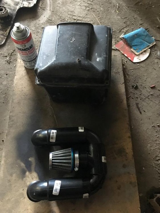

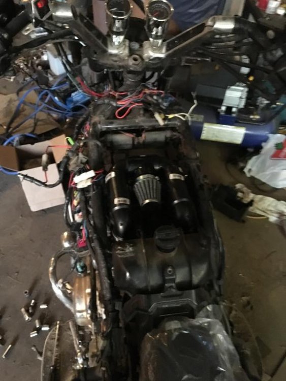

tired of welding today so I decided to build my new air box Here is a comparison of new and old here it is mounted I may mess with it some more to try and get it to sit a bit lower here is the side view I still have to mount the battery see what tomorrow brings Special Thanks to MotorcycleTim I borrowed his idea for the air box Thanks Tim http://kloppenberg.us/chopper.html

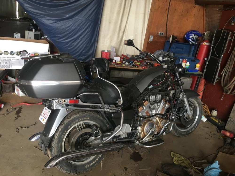

lol a bit out of order now but it worked Heres rear fender and lights mounted test fit of seat I think the rear fender is still a bit high not sure what im going to do to fix this yet frame for rear fender and lights welded up Primed my replacement clutch reservoir rear end painted Diy muffler with cheapy ebay baffle (not tested yet) exhaust welded and welds painted to try and prevent corrosion (I have some wrap I hope to wrap exhaust tomorrow if i have time after work) also you may notice my supreme red-necking lol I ended up using plumbing fittings to get the angles I wanted various other test fits etc PS as always don't mind my shop I'm a slob I know also I do plan on capping the frame where I cut it off just haven't got to it yet

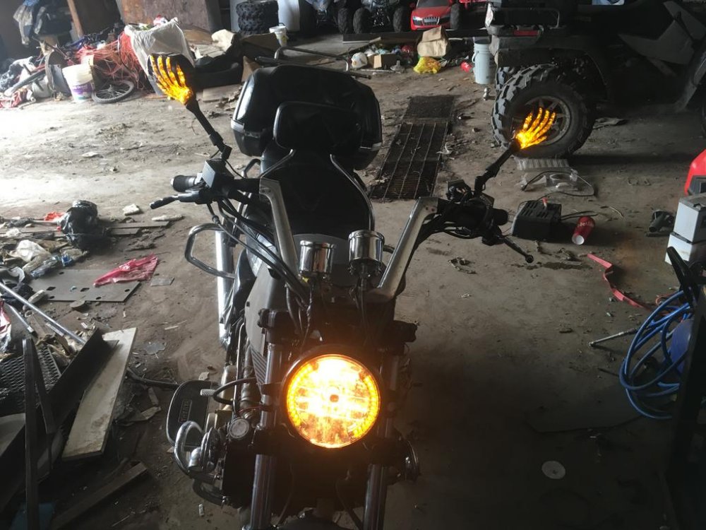

Finally got signal lights working properly . Still gotta mess with the tach, I think I’ll do the same as I ended up doing with the signal lights just scrap it all and start again I ended up reusing some scrap wire to finish bike and the “wrong” colours were messing me up, meh live and learn works now lol

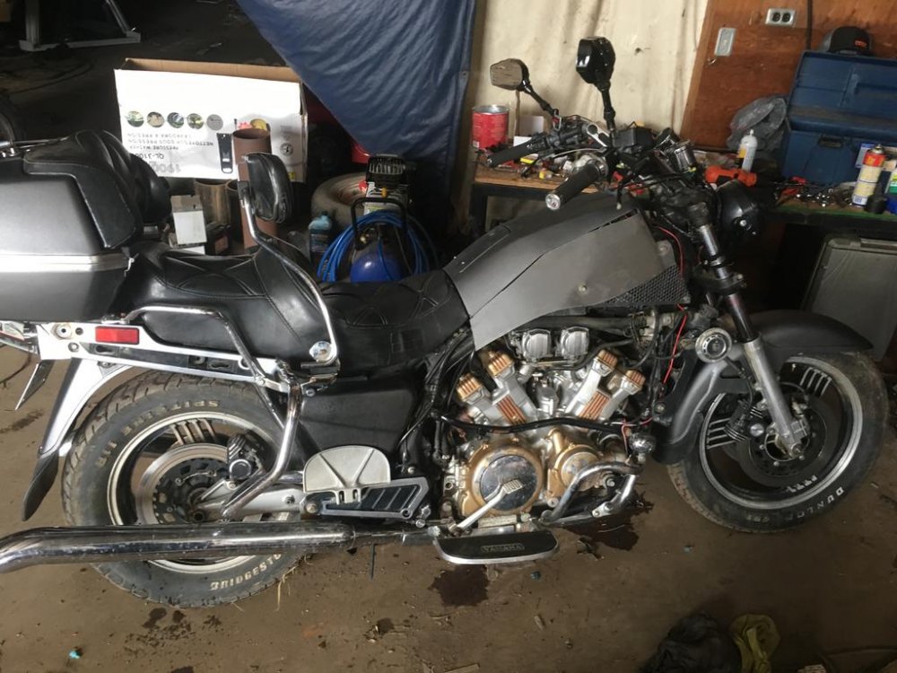

Pictures. Of current progress painted today and finished reassembly, known issues: tach still not working can’t figure it out signals only work when high beams are on ?? gotta mount and move ignition properly (eventually lol) things I still want to do: exhaust once exhaust is finished remount battery below eliminate air box Eventually: rake forks perhaps play with a leading link rewire from scratch to eliminate more @Rats nest” add rear fender redo seat Photos of current phase 1 (elimate old broken plastic move trays and general rewireing leds new headlight etc.)

Another setback today I had ordered a led flasher relay the other day which didn’t work at all, so today a received some resistors and got all my signals working buitifully or so I thought. After reinstalling the headlight it seems the hazards work when ever but the signals only work when the high beams are on??? At least I got them flashing I guess lol, guess I’ll have to stripe er all down again and see where I goofed this time. I also painted the front fender and cleaned the rear fender in prep for paint. I may also paint the trunk and reinstall it until such time as I replace the rear fender. Pictures to come I didn’t snap any today but starting to look like a bike again. Still a bit of a mess with wires but I’m ok with that for now. Also removed my ignition which is simply just shoved up under the fake gas tank for now so leaving 1 panel off to reach the key, I do plan on moving the coils to the sides (like zagger) and relocating the battery to the bottom of the bike (also like zagger) however to do that I must first redo the exhaust which I’m not setup yet to do. at that time I’ll move the ignition and other hard to place relays electrical etc in the cavity where the coils were.

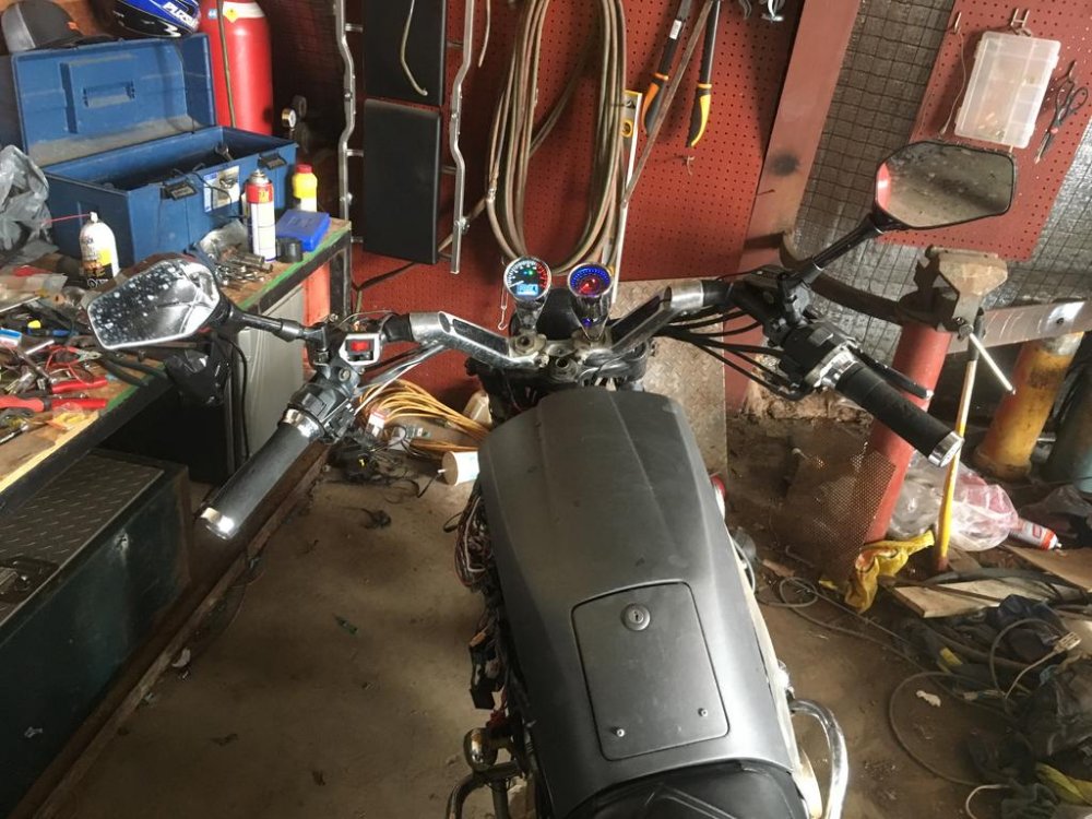

So haven’t felt great the last few days, all I could really do was stay in side search the net for my clutch☹️, anyway got out there for a few min today messed around with my rats Nest of wires lol, I had originally tried to hide the fall over sensor, reserve lighting unit, and canceiling unit behind my head light but I still have a mess of wires to deal with I thought I could get by till phase 2 but meh. I am now thinking about moving my coils to the front of the engine like on zaggers build and stuffing the electronics in where the coils go. So many decisions that or eliminating them, also plan to move the ignition to the side. Anyway here’s what I’m talking about.
