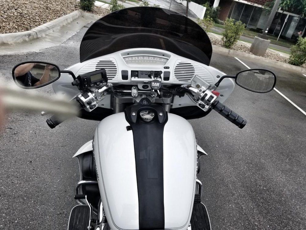

  9. Thank you all.. *the black control box on my handlebar doesnt even light up, so I wondered if a circuit was no longer completed? I will check the fuses and attached the ground strap and figure out what to do with the FM antenna cable

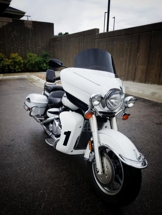

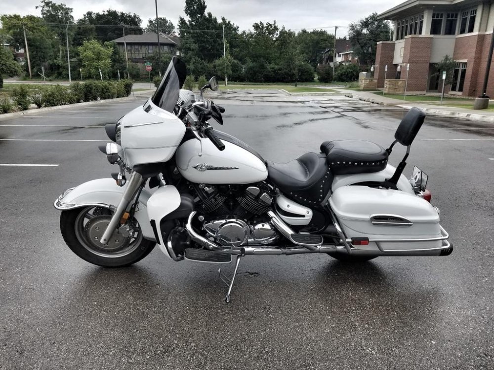

  10. Hi All, Its time to get this FM radio working and Im sure its from the cut wiring that used to go to the Trunk that is no longer attached to my 04' Venture. Perhaps its just the ground strap that needs to be reconnected (i honestly havent touched anything yet to even try it) I went cross eyed looking at the Wiring Diagram.. So here is a long shot, but can anyone Tag which wire does what? (I'm mainly looking to get the FM radio working again) *3rd pic has the Ground strap wrapped in tape with another wire. PICS:
