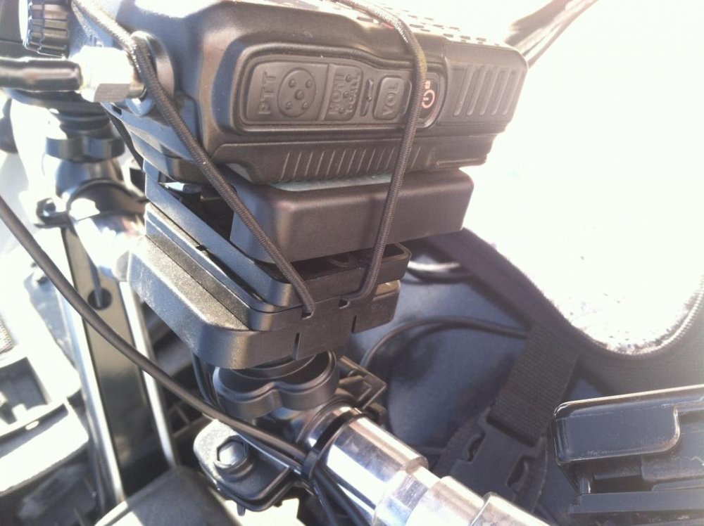

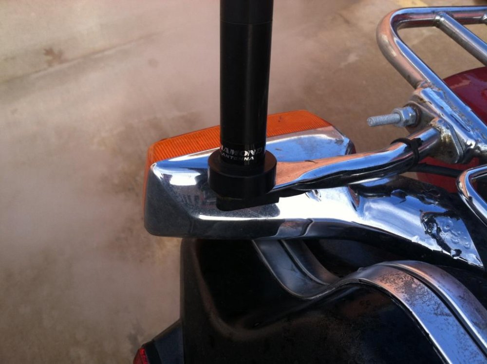

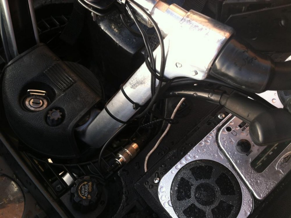

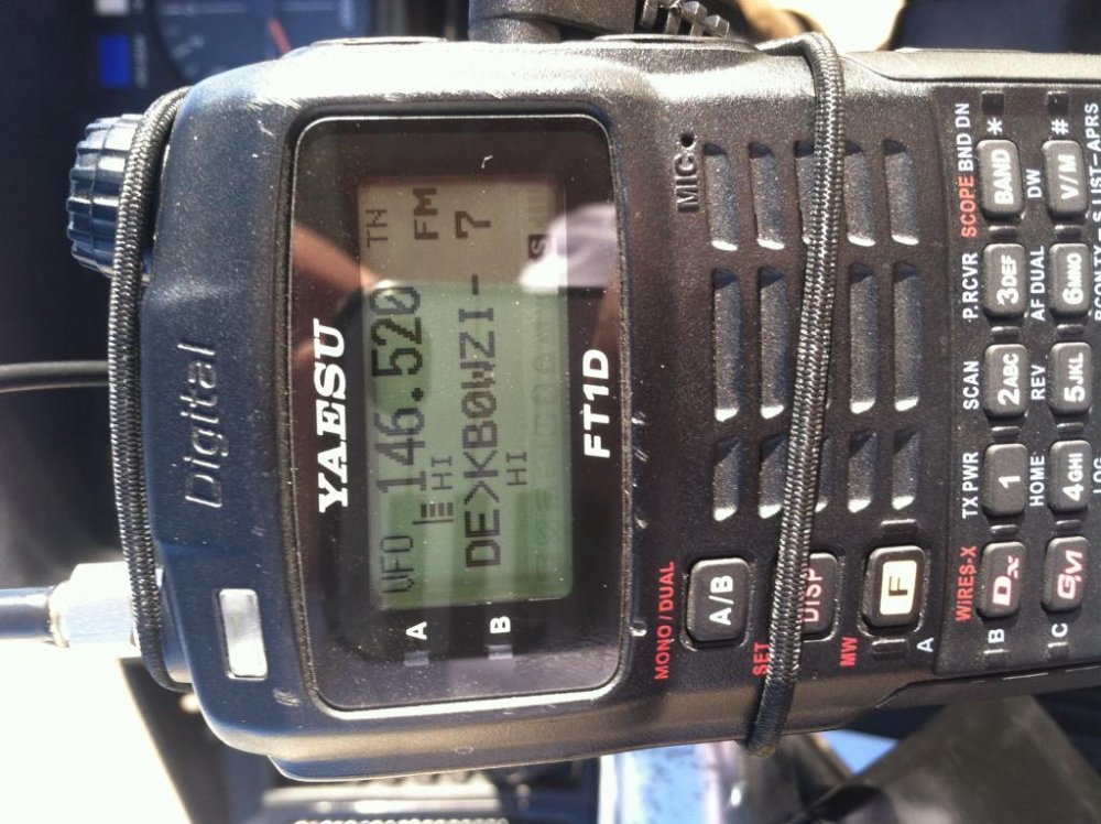

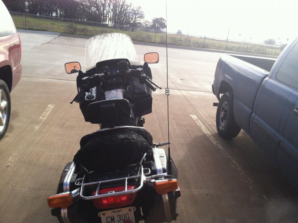

@Larry1963 Hi Larry and crew, wanted to upload some pictures of my Ham radio setup. The radio has a GPS built into it and transmits my position every 2 minutes (or I can change the time). My bike didn't have the radio or any of the fancy stuff. It was a plane jane. I ordered the antenna mount off ebay thinking I would just use a mirror mount bracket to clamp on an antenna too. Once I got it, I just for kicks tried an NMO surface mount and it fit the hole just perfect. I then ordered the 5/8 wave dual band antenna due to lack of ground plane. Screwed it in and routed the wire up to the front. I use a adapter cable to go from pl259 to TNC for the radio. This radio has Shortwave, AM, FM radio, ham bands and many other options. When I get the Sena SH10 i'll be able to use my Sena SR10 headset with the PTT to talk on it too. I'll use this as my AM/FM radio and multi purpose receiver too. I'm having some issues figuring out how to turn the photos upright. After they upload, they seem to turn so not sure. The radio is upright when I look at it. If you have any other questions please let me know. The APRS network is pretty active. http://www.aprs.fi opens a google map with APRS stations overlayed. You can zoom in and out and this will giver you an idea of the coverage. -

Hi Larry, nice to meet you. Let me know when your in town for sure. Yes I am a ham too. KB0WZI. I do have a yaesu ft1d ht mounted with a ram style mount off the handle bars. The where the factory antenna was I put a nmo style mount with a 5/8 wave dual band antenna. I use this radio for the APRS feature. My family at home can track my trip off of findu.com. http://www.findu.com/cgi-bin/find.cgi?kb0wzi-7 i have a sigma Bluetooth headset and they make a Bluetooth adapter with a PTT plug that will hook the radio wirelessly to the headset. I don't have the adapter as of yet but next $150 I will. Mainly just APRS now. It transmits every two minutes. Some areas don't have coverage though but it is cool. Let me know if you have any questions. I'll try to get you a picture maybe tomorrow. Also the radio is water resistant. It has been rained on and through the car wash. Lol. Seems to work. -
