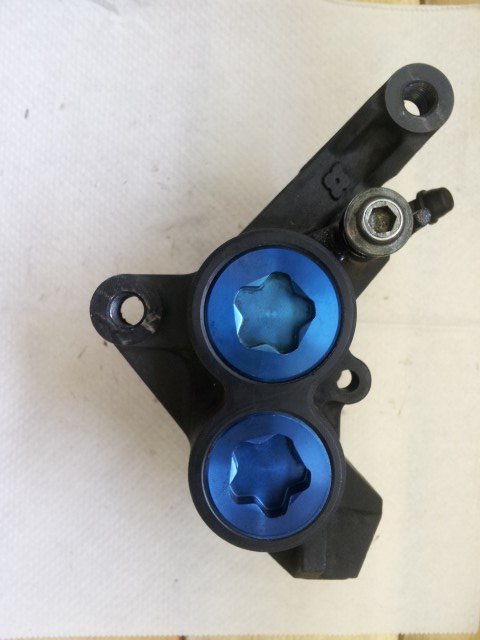

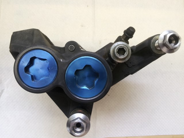

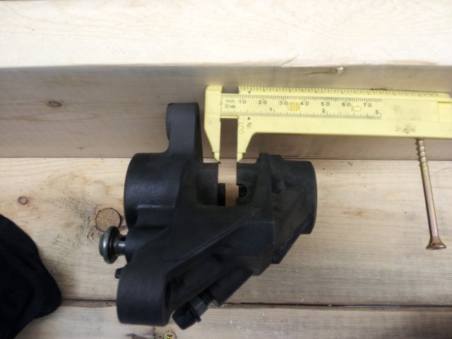

R6 BRAKE UPDATE Thanks for the input Earl. I examined the front wheel (axle) to see if had the correct spacers but it did not cross my mind to trim the current ones. As it is, I ended up machining the calipers 1/32" which amounted to little more than removing the anodizing from around the mounting holes. The machining was a little pricey but the calipers now line up perfectly. I just got back from a 10 day trip through Northern British Columbia and I am very impressed with the upgrade. I now have much better stopping power which was exactly what I wanted when I started this project. It wasn't exactly "plug and play" but pretty close. (Hope my recovery from knee surgery goes half as well) Many thanks to all those who replied! I can't tell you how much I appreciate the good folks on this website. -

Just an update: I installed both R6 calipers on the front of my 89. It is exactly the same issue with both sides...the caliper casting rubs on the outside surface of the rotor. Consistent on both sides. I then installed both calipers on my 93 and although I have some clearance ... it just clears and does not rub. I have measured all the related distances on the 89 and compared with my 93, it all checks out. There does not seem to be any damage to the forks or anything else for that matter. I need 1 mm to center the rotor in the R6 calipers for both sides. I am considering machining off the caliper at the mounting holes which will give me the required distance (1 mm). -

The issue is with left side front. I reinstalled the original caliper and inspected it to see if the rotor was centered in the slot in the caliper casting. It also seems to be slightly off center but not affected as the slot in the casting is 2mm wider than the R6 caliper. I installed the R6 caliper on my 93 and it fits but just barely (1mm clearance on both sides). I guess that means I have to find 1mm clearance somewhere for the R6 caliper to work on my 89. Not sure where to start. -
R6 Brake Upgrade Issue
bobber replied to bobber's topic in Venture and Venture Royale Tech Talk ('83 - '93)
Thanks for the reply and photos. The rotor is stock Yamaha and the thought of fork damage did cross my mind. I have a 93 Venture that I can try the R6 caliper on and see if I get the same fitting issues. It seems that I have the correct R6 caliper unless someone chimes in to the contrary. Let you know how it goes. -
I was never impressed with the braking on my 89 Venture so after absorbing a little info from some of the very knowledgeable folks on this website, I gathered all the necessary parts and ventured forth (no pun intended). The blue dot calipers I acquired were off of an 2004 R6 with the appropriate mounting needed for the Venture. I slipped the old calipers off without unhooking the brake lines and tried the new calipers for fit before installing the new brake pads. The R6 caliper mounts slightly off center and the rotor rubs on the caliper casting. The rotor is true as the casting remains in contact as I turn the wheel. I noted that the cut out in the caliper casting (allows the rotor to pass through) was smaller than the original caliper. I measured the thickness of the rotor at 7mm and the cut out at 9mm. Not much room for error. Makes me wonder if I have the right R6 caliper. I have supplied some photos of the R6 caliper and I have a few questions. Is this the correct caliper for the conversion? If it is the correct caliper why would the rotor rub on the casting? Any assistance would be much appreciated.
