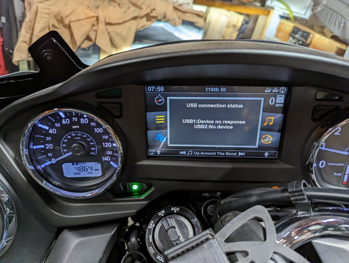

dunkins1 Posted April 20, 2023 Share #1 Posted April 20, 2023 Hello all, Wondering if anyone has experienced this. On my 2018 SVTC, I plugged my phone into the USB to charge it while I was playing Sirius XM. The following message kept flashing. Any ideas? Bill Link to comment Share on other sites More sharing options...
mcsteve Posted May 17, 2023 Share #2 Posted May 17, 2023 I just purchased a “new to me” 2018 and am having the same issue. In my case, I plugged my iPhone 13 into the front USB connection to charge while riding and now I continuously get that message flashing on the screen, even though the phone is no longer connected. I’ve dropped the bike back at the selling dealership for them to diagnose but they say they have never seen this before. Link to comment Share on other sites More sharing options...
mcsteve Posted May 18, 2023 Share #3 Posted May 18, 2023 Got the bike back from the dealer today and they said they had to re-flash the head unit and the USB message is gone. Link to comment Share on other sites More sharing options...

dunkins1 Posted June 19, 2023 Author Share #5 Posted June 19, 2023 mcsteve- have you tried to charge your phone since the reflash? Does it work properly now? Link to comment Share on other sites More sharing options...
dunkins1 Posted June 19, 2023 Author Share #6 Posted June 19, 2023 Don't mean to belabor this topic but for the heck of it, I hooked up my work iphone to both USB connectors and didn't get that error message. I have a Google Pixel 6 (android) that appears to triggering the message. Not sure if it is a coincidence or not. Link to comment Share on other sites More sharing options...
mcsteve Posted June 19, 2023 Share #7 Posted June 19, 2023 17 hours ago, dunkins1 said: mcsteve- have you tried to charge your phone since the reflash? Does it work properly now? I’m not one who likes to tempt fate so I have not plugged my phone back into the front port. I probably should as it is still in warranty and if the problem reappears I can still have them address it. I’ll try tomorrow and post my result. Link to comment Share on other sites More sharing options...
captdrac Posted July 12, 2023 Share #8 Posted July 12, 2023 I had the same problem. I had the system re-flashed, well the entire informant system was replaced (another story) and it worked for the phone I had at the time. I got a new phone and the same problem returned. We just have a 2016-17 system that doesn't auto update and Yamaha likes to charge (map update) to send us a update. Link to comment Share on other sites More sharing options...
