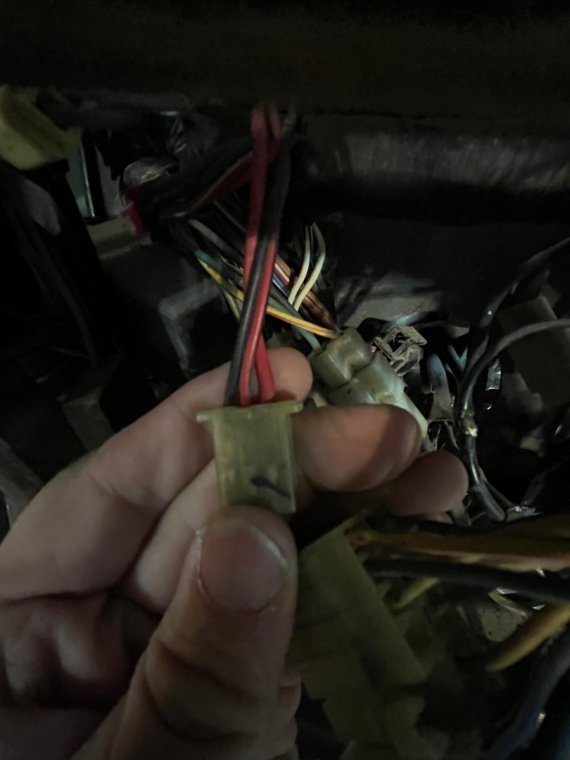

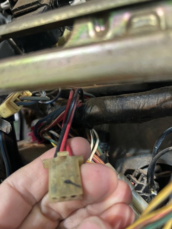

Apostle Wilson Posted January 30, 2023 Share #1 Posted January 30, 2023 Hey guys, I just purchased a new to me 83 venture 1200, it’s running okay currently but I’m don’t have tail light or running lights. The Brake, turn signals and hazards work fine. Behind the headlight I found some wires that were unplugged. I looked and did not find a mate. anyone have any clue what this plugs into? Link to comment Share on other sites More sharing options...

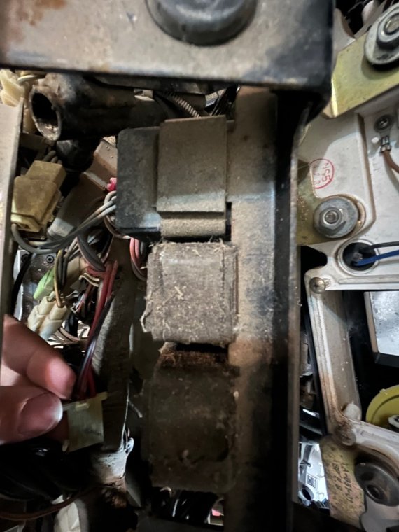

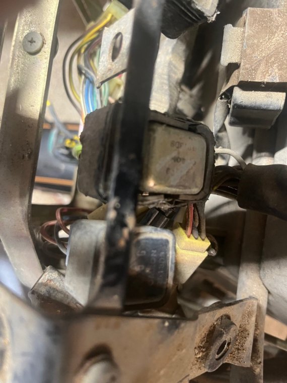

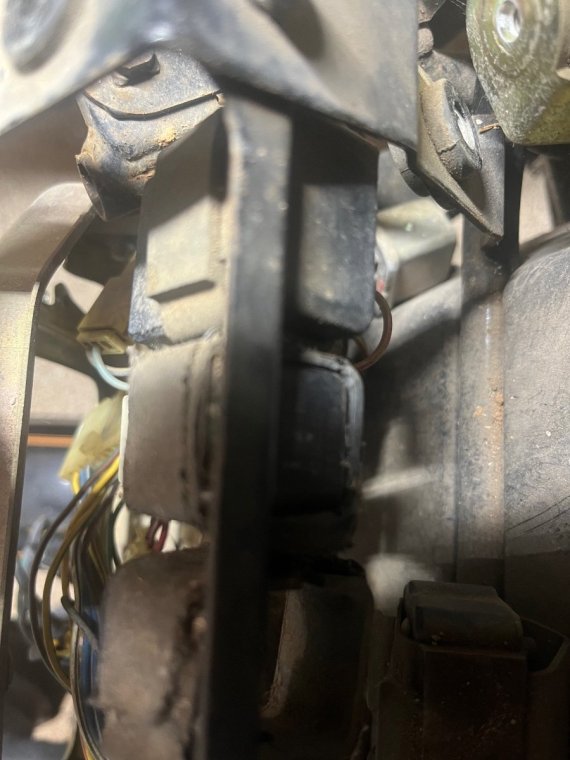

Apostle Wilson Posted January 31, 2023 Author Share #3 Posted January 31, 2023 3rd update. I’m missing a relay of some sort. Not sure which one it is, and the others were not in the slotted space. I replaced them the best I can. If anyone has an idea of which one in need?? I’ll try and find it in the service manual. The pics are from right to left. The 3rd slot is the empty one. I’m thinking the wiring harness plugs in it. Link to comment Share on other sites More sharing options...

Apostle Wilson Posted February 12, 2023 Author Share #5 Posted February 12, 2023 Solved** The plus was originally intended for an audio system which my bike does not have. I found the missing relay hiding in some wiring. I had to fix the headlight wiring as it was messed up from the previous owner but after throwing a new bulb in and correcting the wiring my tail lights and running lights work as they should. 2 Link to comment Share on other sites More sharing options...
