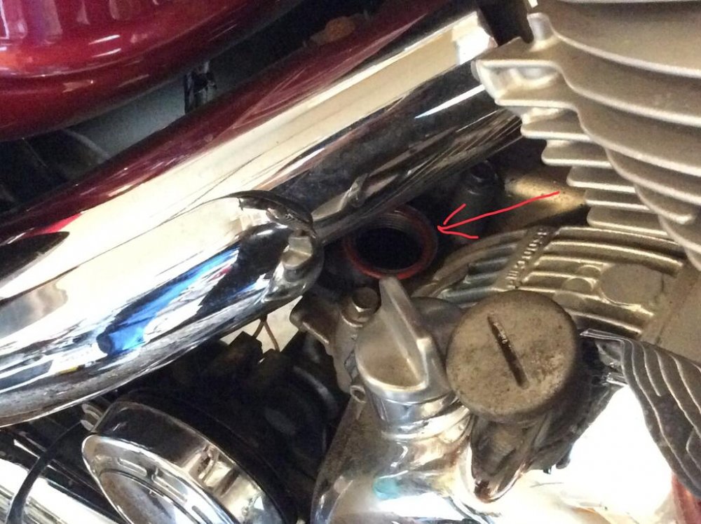

LaclaMoe Posted July 16, 2020 Share #1 Posted July 16, 2020 Removed and its dry. What goes in? Can’t find it. Link to comment Share on other sites More sharing options...
MiCarl Posted July 16, 2020 Share #2 Posted July 16, 2020 That is where the oil fill was on a first gen and the V-Max. On the 2nd gen they put another oil fill in the clutch cover. At some point they stopped drilling and tapping that hole. Later castings just had a flat spot there. You could fill the oil there, but it's hard to reach. Link to comment Share on other sites More sharing options...
LaclaMoe Posted July 16, 2020 Author Share #3 Posted July 16, 2020 Thanks, never occurred to me. i’d guess the clutch basket design engineer was demoted to moving the oil fill hole.😂 Link to comment Share on other sites More sharing options...
