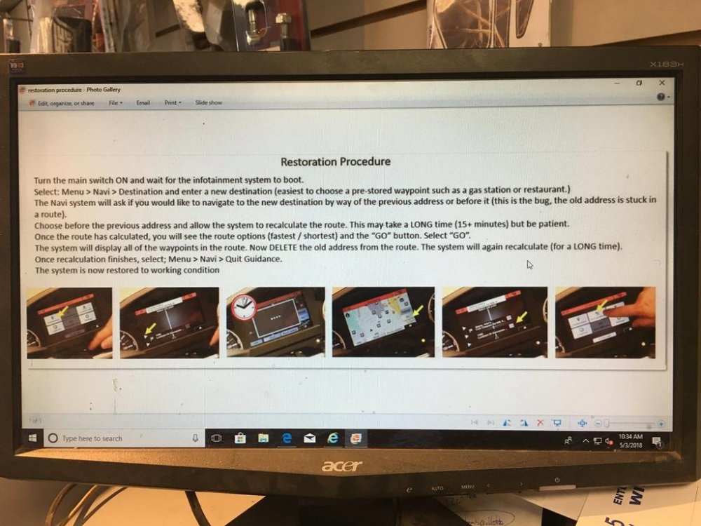

Mr Gadget Posted August 28, 2019 #1 Posted August 28, 2019 I've had my 18 SVTC for less than a week. GPS was working fine through yesterday afternoon. Later in the evening, I started it and got the "navigation system not ready" message. I installed the Navigation Update and still have the issue. Anybody else gotten this?
Freebird Posted August 29, 2019 #2 Posted August 29, 2019 I found this elsewhere and posted it here for another member. He reported. back that it solved the problem.
Mr Gadget Posted August 29, 2019 Author #3 Posted August 29, 2019 (edited) I think this is the bug I have. I can try to create a route and it does seem like it is stuck on a route. I'll try this when I get home. Thanks!! **Update: It worked!! Thanks again, saved me a trip to the dealer** Edited August 29, 2019 by Mr Gadget

Chuckles_18GT Posted September 1, 2019 #5 Posted September 1, 2019 Mr Gadget said: I think this is the bug I have. I can try to create a route and it does seem like it is stuck on a route. I'll try this when I get home. Thanks!! **Update: It worked!! Thanks again, saved me a trip to the dealer** I have the Eluder GT with Navigation, and it will stay on the selected route until I reach the destination or select the "Quit Guidance". The Quit Guidance button is located thru the Navigation Menu, but I haven't figured out how to get it on one of the shortcut buttons available from the map screen, you actually have to go thru the main menu to get to it. Yes, it took me a while to find it, and I'll have to read up on that as it is annoying not to be able to cancel the route from the main map screen. The "Navigation system not ready" message shows up every time I turn on the bike, but is usually gone in about 15 seconds. If we're on the road, and I see everybody mounting up, I'll usually turn the key on then, and it's ready to go by the time we actually start moving. Love the bike overall.
Oldengineer Posted September 7, 2019 #6 Posted September 7, 2019 I had the same problem and process in this thread worked for me too.
