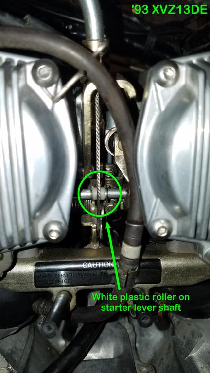

Bob K. Posted September 14, 2018 Posted September 14, 2018 I'm baffled. Consensus says I have the primary throttle cable routed incorrectly on my '93. It's not supposed to go around the white plastic roller/bearing on the starter lever shaft. Instead, the throttle cable is supposed to go on the inside of the starter lever shaft and directly to the throttle linkage. The angle of the throttle cable bracket does seem to support that idea in that it points toward the throttle linkage rather than toward the plastic roller. Yet when I look at this area, I can't see anything that would then touch the plastic roller, so what is its purpose? It's not needed to position the starter lever shaft or hold anything in place on the starter lever shaft. Is it a vestigial remnant of some sort? I don't want to reassemble any further until I'm positive I've got everything back where it's supposed to go.
Prairiehammer Posted September 14, 2018 Posted September 14, 2018 I confess that I don't know the "why", but I do know the "where" is behind the plastic roller. I think that Marcarl's explanation of that plastic roller being a spacer is valid. Perhaps, in some situations the throttle cable MAY touch the enricheners actuation shaft and so Yamaha did a "CYA" to prevent unexpected throttle sticking?

Bob K. Posted September 14, 2018 Author Posted September 14, 2018 It is a position guide for the cable to cradle! Steve--Are you being humorous or serious? Explain further, please. My throttle cable, when routed correctly inside the shaft, would never have enough slack in it to even come close to touching the white plastic roller. By the manual, Throttle Cable #3 is only supposed to have 1-2 mm of free play. Weird stuff. Those original designers need to be interrogated under a bright light!
Patch Posted September 14, 2018 Posted September 14, 2018 Steve--Are you being humorous or serious? Explain further, please. My throttle cable, when routed correctly inside the shaft, would never have enough slack in it to even come close to touching the white plastic roller. By the manual, Throttle Cable #3 is only supposed to have 1-2 mm of free play. Weird stuff. Those original designers need to be interrogated under a bright light! Yes I am but as you say it doesn't really do much, still a good principle. So you can always count on Pairriehammer to not guess. Take a look at 3-3 bottom left hand of the page,,, you clearly see the nylon bushing without interruption of the cable. Page 5-1 item 23 backs what Carl describes. So what can happen is when you snap the throttle back, its hot in that area potentially it can move away enough to snag So because this is a throttle cable their is still a practice of protecting and if possible completely eliminate any risk to limiting a free expected smooth operation of,,, period. Patch;)
Patch Posted September 14, 2018 Posted September 14, 2018 I'll just add Bob that when the throttle is working correctly then everything is as is expected, but this is a cruise control rig and there is a splitter an added complexity. On another bike I have I had to replace the short cable from the cruise splitter it was well documented in the manual not so much in the Venture manual but is showing if you look carefully. Page 1-157 item 14

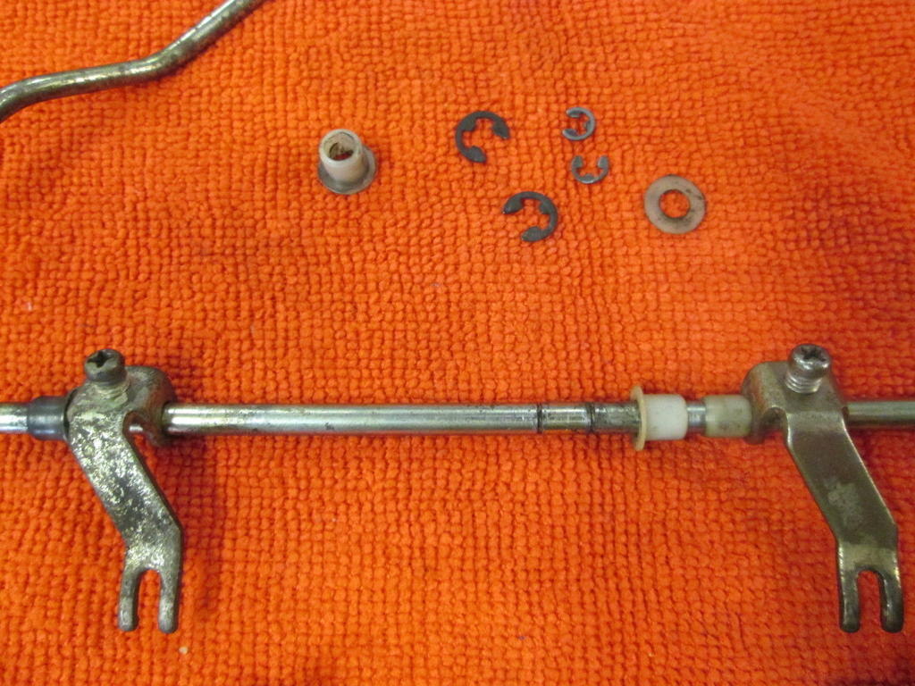

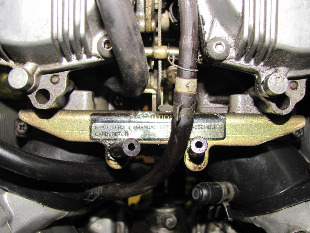

Prairiehammer Posted September 15, 2018 Posted September 15, 2018 I'll just add Bob that when the throttle is working correctly then everything is as is expected, but this is a cruise control rig and there is a splitter an added complexity. Steven may have hit on the reason for the roller, kinda. Perhaps during cruise control operation, the servo introduces slack in the throttle cable and the roller is to make sure that there is no interference with the enrichener/starter/"choke" actuating shaft? Note that on the nearly identical V-Max carbs, the same actuating shaft has the grooves for the circlips (that locate the roller), but the circlips and roller are not used or needed. Why? Because the V-Max does not have cruise control? (Ignore the red arrow in the photo, it is not relevant to this discussion.)
Patch Posted September 15, 2018 Posted September 15, 2018 Yes when I was looking up the pages and item numbers I simply forgot to include it, likely because it was at the end of the book. The cruise splitter pulley and pin can ware as well which can if the ID. goes out of round example, will generate some slack. Not a complaint we hear about on these bikes to my knowledge. Also not an item we ever recommend lubing.hmm Perhaps not servicing this part may be for the better verses the risk of messing it up? I wonder..
