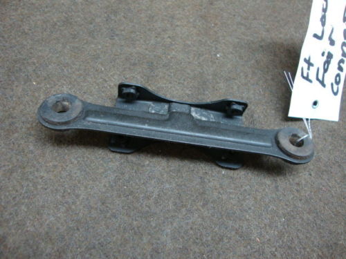

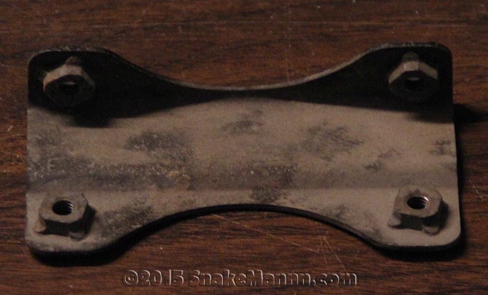

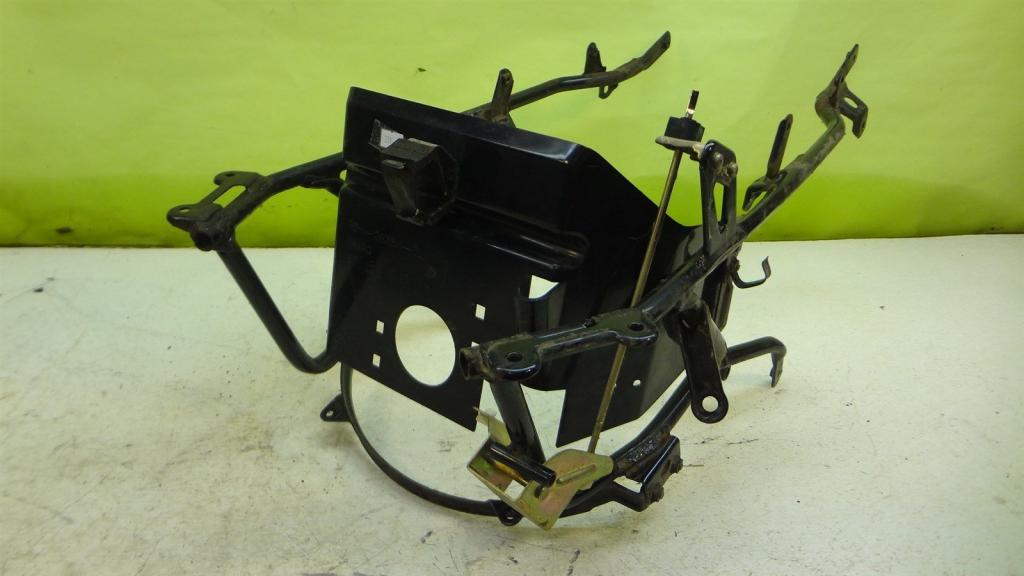

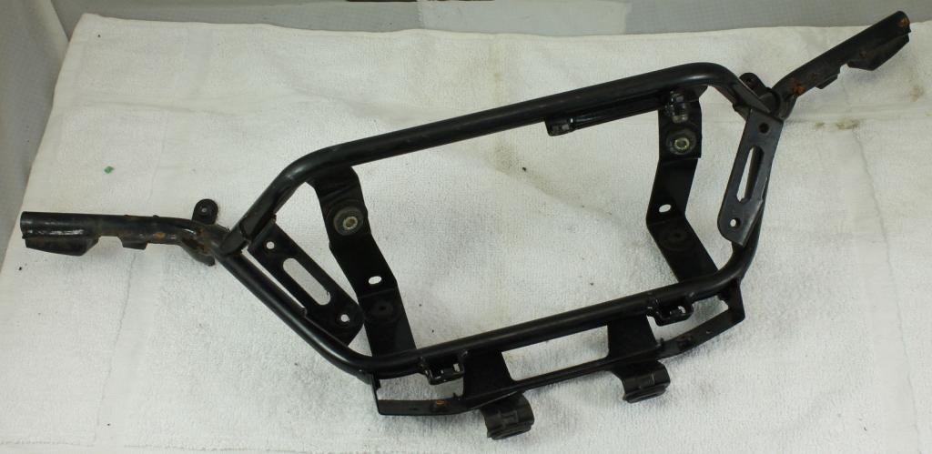

Prairiehammer Posted December 20, 2015 #7 Posted December 20, 2015 garyS-NJ said: So Kevin, I could replace the left and right stays to accommodate the light but my '84 fairing will bolt back on? How's this ring with randy's input below? Oh and yes, thanks, let me look at that link for projectors Gary, You will need to replace the left fairing stay to accommodate the MKII headlight adjuster. The headlight adjuster mechanism on the MKI will not work on the MKII headlight assembly. There is an additional mount (a tube) on the fairing stay for the MKII adjuster. See pics below. You may not have to replace the right fairing stay to mount the MKII headlight, but I wonder if the MKI headlight mounting tab will interfere with the MKII headlight assembly. Perhaps just cut off the mounting tab if it interferes with the new headlight. According to Randy, the tab is not a problem? The fairing connector (under the headlight; joins the halves of the fairing) must be changed to accommodate the MKII headlight. The upper or middle fairing stay must be changed to use the MKII headlight. Your 1984 fairing halves will bolt back onto the MKII fairing stays. But of course, the fairings must be removed first to replace the stays.
