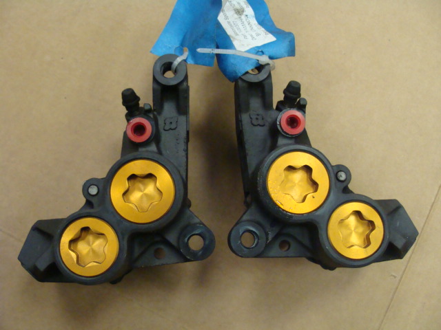

BratmanXj Posted November 20, 2014 #2 Posted November 20, 2014 1st, try sending SkyDoc a PM since all the classified listings got wiped out with the forum update. 2nd, any R1 or R6 NON-RADIAL caliper that has "horizontal" mounts like the black & gold picture attached. You can even look for early model RS Warriors or later model Road Star 1700 for calipers also. Mine came from an '02 RS Warrior and included the "correct" 14mm master.

skydoc_17 Posted November 21, 2014 #4 Posted November 21, 2014 Hey Rich, The "Gold Star" R1 Calipers had solid Anodized Aluminum Caliper Pistons. (lighter, more piston contact surface, dissipated heat faster, less prone to corrosion) The "Blue Star" R6 Calipers have the hollow steel piston cups found in the RSV and First Gen. Calipers. Other than that one exception, the Caliper bodies are the same. Because you most likely WON"T be going 180 MPH on your RSV Rich, you won't notice the difference!
uechi kid Posted November 21, 2014 Author #5 Posted November 21, 2014 skydoc_17 said: Hey Rich, The "Gold Star" R1 Calipers had solid Anodized Aluminum Caliper Pistons. (lighter, more piston contact surface, dissipated heat faster, less prone to corrosion) The "Blue Star" R6 Calipers have the hollow steel piston cups found in the RSV and First Gen. Calipers. Other than that one exception, the Caliper bodies are the same. Because you most likely WON"T be going 180 MPH on your RSV Rich, you won't notice the difference! Yeah, 180 isn't likely until my next trip to Kauai. So if I'm think new calipers go with the least expensive of the two? I've been searching using the models and years in your email.
