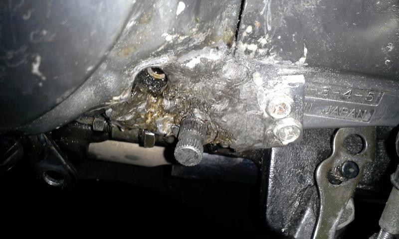

  1. I recently bought an 1988 Venture Royale that has floorboard and a Heel-Toe Shifter. The shifter linkage attaches to a shaft that comes out of the lower left side casing. What I had missed on the inspection was that the metal around the hole where the shift linkage attaches to the shaft was cracked and had been repaired. Sure enough, an hour into riding it and the metal broke; one of the edge pieces of the hole. Steel Epoxy putty and JB Weld don't hold to spec for a repair solution. I can put a standard footpeg shifter on it, but the broken/cracked metal problem remains. Other possible repair strategies are: a. I also have an 1984 VR and wonder if I use that piece. Is it too small because the 1984 is a 1200cc and the receiving bike is a 1300cc? b. Can I take off the lower side cover and weld the broken piece to the cover, with more metal in the back to reinforce it? Anyone with any other ideas? Anyone have this problem resolved? Thanks, Richard in AZ
