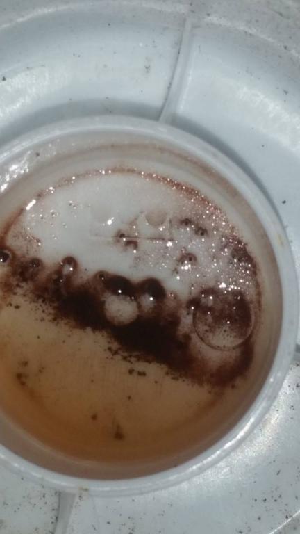

  11. ok thanks, hopefully the clutch release is all thats wrong.
