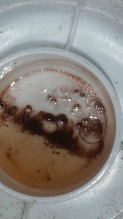

finally got all the air out, but fluid is pouring out of the bottom of the engine. its not the hose thats leaking from what i can see so i'll need to remove the clutch release and replace it or rebuild it, thanks for all the advice. Btw i didn't see a copper washer on the bottom bolt of the middle gear cover. -

the bike has sat for 5 years and the reservoir was empty so i filled and bled, i zip tied the handle to the bar and gonna check it tomorrow -
