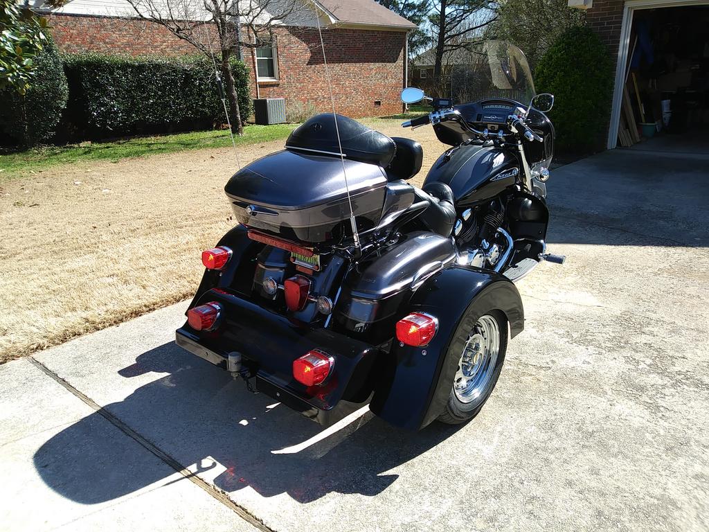

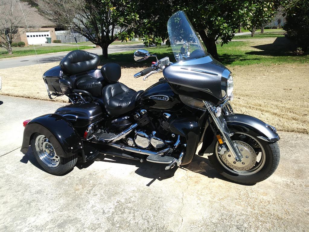

	Well, it took some time but I finally got the Voyager Trike Kit and installed it on my RSV. I bought the kit used, and decided to try to "do it right." First I had to get my lowered bike restored to stock height. It had been lowered front and rear. The rear is now raised, but I have not yet raised the front, as I want to see how it handles first. Then I took all the parts that mount on the bike and sandblasted all the old paint, oil, and rust off them. Fortunately a friend had a sandblast station I could use. Then, I painted the parts and put them in the same friend's paint oven to bake on. While the paint was baking, I cleaned up the main portions of the trike. I found that the previous owner had done some kind of lighting modification, so I had to repair all the the wiring harness. No big deal. All back to stock so I was good to go. So I thought! More on this later. I then removed the tires and took them to have the balance checked. That's when I realized that although looking good, they were 8 yrs. old. At the tire place I asked if they could just pop one open so I could look inside. Sure enough, there was degradation and material loose inside the tire. So, a new pair of 13" radials went on. With things cleaned up/repaired, a friend and I started the installation. Definitely a 2 man job. It took about 5 hours, and if you follow the instructions, and use some common sense, geometry, and curse words, it eventually goes together. There were a couple of things we had to do twice, but we got it together, sat back, and congratulated each other. It looked pretty good! I then began the electrical wiring task. A converter for a 5 wire (RSV system) to 4 wire (Voyager system) was provided. Pretty straight forward. And that's when Murphy showed up. I had running lights, but no brake lights, and all four lights blinked no matter which signal was engaged. Also, the seemed to blink at a different rate than my LED turn signals. I rechecked all my wiring and connections. All looked good, so I deduced that the converter must be bad, and I got a new one, only to find the exact same problem existed. By now, I had spent several hours on this problem, so I decided to quit for the day, lest my mental state be reduced to rubble. The next morning I rechecked all the wiring, and re-did all splices in the wiring harness.That ate up another couple of hours. How could anything so simple be so Problematic? I am a Ham Radio enthusiast, so wiring is not an alien skill set for me. Becoming more and more frustrated, I finally broke down and called MTC Voyager to talk to a Tech about the problem. "Frank" and I walked through the wiring from the bike to each light step by step. All was correct. I sat back and just stared at the bike. It was at this point that the wisdom of old age led me to the philosophy of the "The Point of Diminishing Returns." I already had great rear LED lighting on the RSV itself. Did I really need Run/Turn/Brake incandescent lighting on the trike kit. Nice, but not really necessary. Thus, in order to keep myself from having a mental breakdown over the lights, I decided that Running lights were sufficient. I removed the 5 wire to 4 wire converter and just wired the running lights to the bike. By this time I had spent almost 2 days on the lighting issue. Done and Done. I took the bike out for a ride and WHOA BABY! This thing really needs some effort to turn! Gradually over the next hour I became more and more accustomed to having to steer vs. lean. I really had to make turns slowly compared to being on 2 wheels. I suspect that over time I will develop Popeye forearms, and I must admit that one time at a stop sign I put my feet down! Felt pretty stupid in that moment. The bike to runs straight, but I re-adjusted the pre-load to 3/4" as someone had suggested. I liked that ride better. So now I will spend time on local rides to get more and more accustomed to the "Trike" before any long trips. So far I'm HAPPY!

	Thanks Condor. Your trike looks good! Can the side bags open all the way? I think I have located a kit that is currently on an RSTD and the owner is willing to sell separately. Should be direct fitment to the RSV. The issue at hand, however, is that MTC says the kit was originally sold for a Harley Dresser. Therefore it must have been moved from the Dresser to the RSTD....and I hope done with the proper hardware! It's a Classic kit that is 6.5 years old. Price is $2500. Unfortunately, I will have to make a 1000 mile round trip just to put my eyes on it! Surgery & Chemo are complete. Have had 3 subsequent scans which have been clear! Time to get back to RIDING!!! Steve

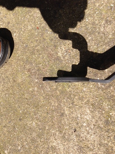

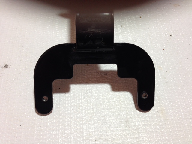

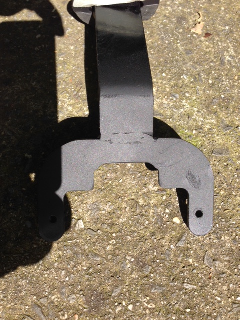

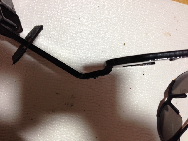

	After my RSTD (Darlene) went Tango Uniform, I replaced her with a 2013 RSV (Amanda) and I attempted to mount my RSTD Utopia backrest on the RSV. I quickly realized that a modification of the mounting bracket was needed to keep the bracket from pinching wiring on the RSV that does not exist on the RSTD. Fortunately, I have a handy friend so we set out to do the necessary modifications. I hope the pictures are in enough detail. The first thing we did was create a bit more clearance for the wires. We cut a little bit out of the bracket as shown below. Standard RSTD bracket First modification for increased clearance. We cut out about 1/4 inch and beveled edges. Yes, my friend is embarrassed by the weld! The next modification to create more clearance was to relocate the weld for the vertical portion of the bracket. I'm sorry I didn't take the picture from the same perspective. Standard RSTD Bracket. Note the offset. Modified bracket. Note change in weld point to eliminate the offset. There is now plenty of clearance for the RSV wiring. Backrest is on and works great! Steve
