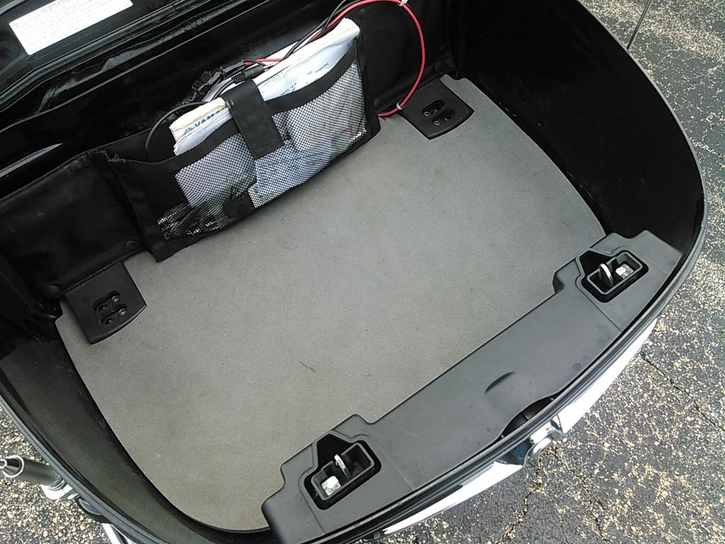

I've removed the saddlebags and went for a ride with no joy as a result; the rattle was still persistent. Did do a bit of cleaning while it was apart but nothing worth mentioning except tightened all fasteners very snug: Reinstalled the saddlebags hoping a simple repositioning of parts would do the trick but again, no joy. I went to remove the trunk and discovered I'm a victim of my own "**** for brains" mentality sometimes as evidenced by these photos. The first being the empty trunk: Now as soon as I lifted the edge of the trunk foam, this is what I discover laying on the right side: I'd purchased that section of hydraulic brake line several years ago for a Land Rover I was working on not remembering I'd stuck it in the trunk, and having to purchase another section to finish the job. Such a ignorant mistake on my part thought I'd share. This rattle has really driven me nuts all summer since starting to ride again but never had an inkling to check under the mats for anything until attempting to physically remove the tour package units. I guess we live and learn. Thanks to all for the assist. With all the findings, repairs, modifications, etc. I'm doing and have done to this bike it is really starting to grow on me. Even had an older gent and wife riding an Electra-Glide Classic tell me it was a good looking bike at a stoplight last evening. Older gent lacking all the riding garb and tatoos; his comment was sincere I felt. Rob
