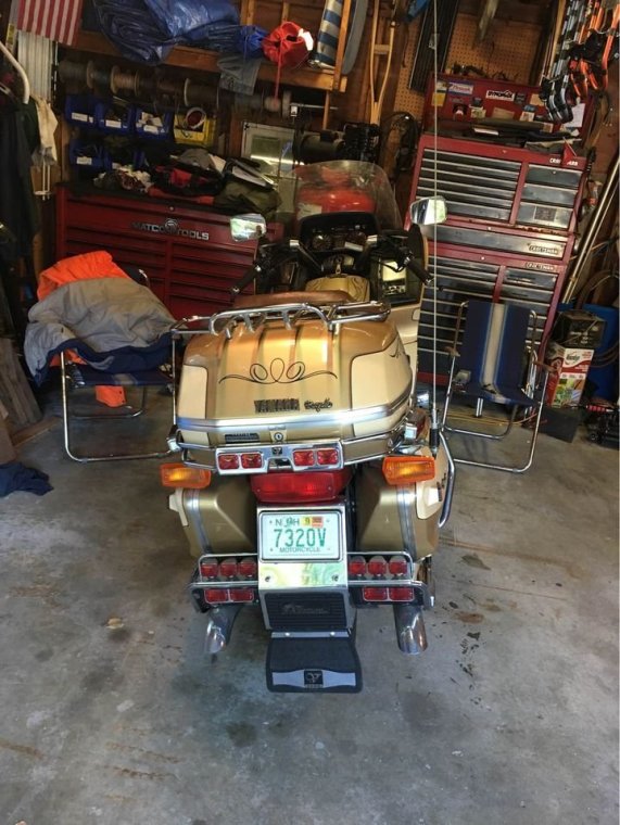

Ref picture below. These red lens covers on the Drag specialties rear end are now almost 40 years old and a few have cracks etc. Anyone know where new ones can be obtained?
