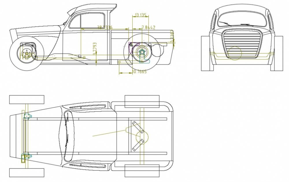

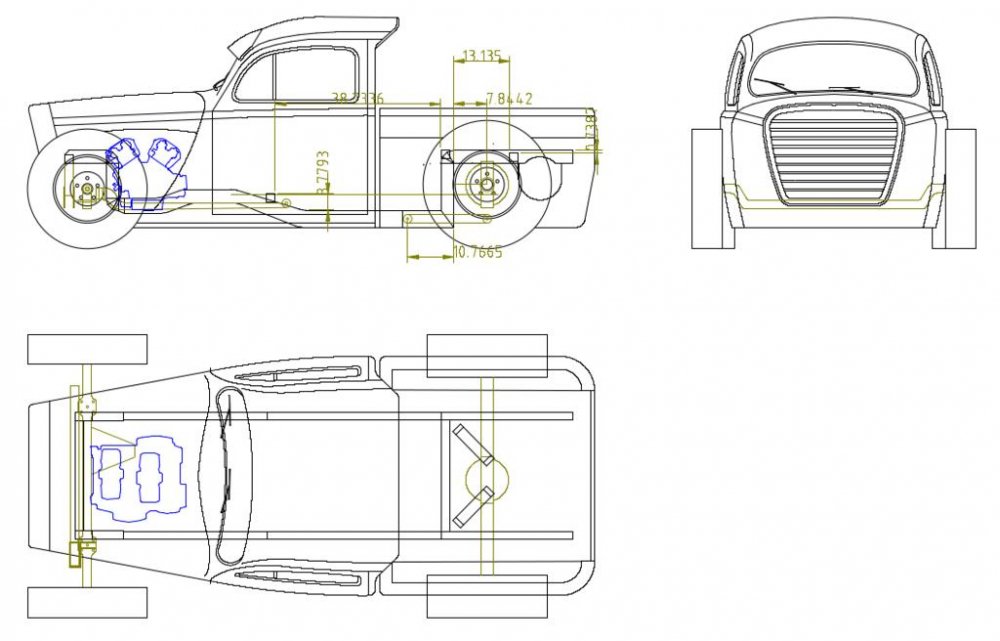

  7. @zagger - Thanks for the dimensions! I did a quick sketch and came up with this: I think it will fit quite well. I did a Suzuki twin cam GTI engine (~100hp) into a Geo Metro swap once so I feel like I have an idea how fast it will be. It should end up well under 2k lbs. Of course not as fast as a bike though. Suzuki/Metro: 99hp/83ft. lbs. 1.3L, ~1700lbs XVZ12/rod: 95hp/??ft. lbs. 1.2L ~1800lbs - Way cooler

  10. Here is what I'm working on. It is a Geo-Metro sized hot rod truck. I wanted something different for the engine and settled on either a v4 or I3. At first I thought about building a custom engine, but when I saw what you guys have and how it sounds, I was sold. I'm currently working on the chassis.
  11. Wow, thank you guys for the kind welcome! You'd be surprised the number of places a person gets hated on for doing something out of the ordinary. @sleepy2 - I don't think so? I'm a noob here . The one I bought is an '83 if that helps. Reading in this forum, guys are swapping V-Max heads onto older blocks and saying things like "the blocks are the same". I haven't read of anyone doing engine swaps yet, but I just started. Basic length, width and height of the engine would get me started, but mounting points would be awesome! There are tons of things I could use, but don't let me put you out. A list off the top, in no particular order, if you really want to measure stuff - Driveshaft offset from center of engine - Overhead location of intake ports (for building a custom intake manifold) - Carb throat diameter - U-joint cap diameter - U-joint height (top of cap to top of cap)
  12. Hey guys. I am building a compact hot rod and just purchased a xvz1200 for power. It won't be here for a while so I was hoping to get some basic external engine dimensions so I can draw it into the plan. I searched, checked out the tech section, looked through the manual and googled. You guys have any info I can start with? Basic wlh is a start, but the more detailed the better. Thanks!
