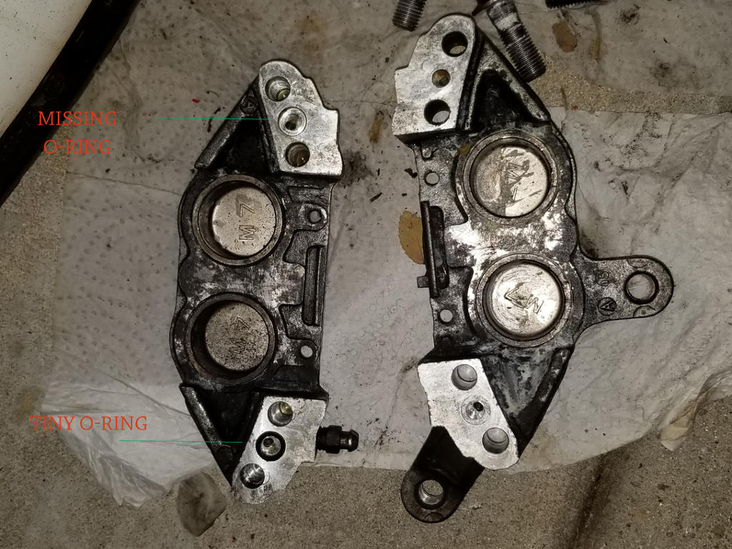

RSTD front brake part number
revpat replied to revpat's topic in Royal Star and Royal Star Tour Deluxe Tech Talk
Thanks for the input guys. I ended up buying a used complete caliper off ebay and installed it and finally got it filled with fluid today. Pretty big deal and I'm not sure the calipers are the problem as the brake handle itself still sticks. So now I'm off to figure that one out. -

I just bought a '96 RSTD and only had a short ride home and noticed the front brake was weak/grabby. It was really hard to squeeze with little braking and then it catches and grabs. Not sure what is causing this. I took the right brake off and found one of the pistons (or whatever they are called) stuck. I got it unstuck but had to separate the two sides to get them pressed back in. In doing so I think I lost a tiny o-ring where the fluid flows between the sides. So here's my question: 1) It there suppose to be an o-ring on both holes? 2) If so, does anyone know where to find a part number or where to get one? I'll include a pic. Thanks for any input. Revpat
