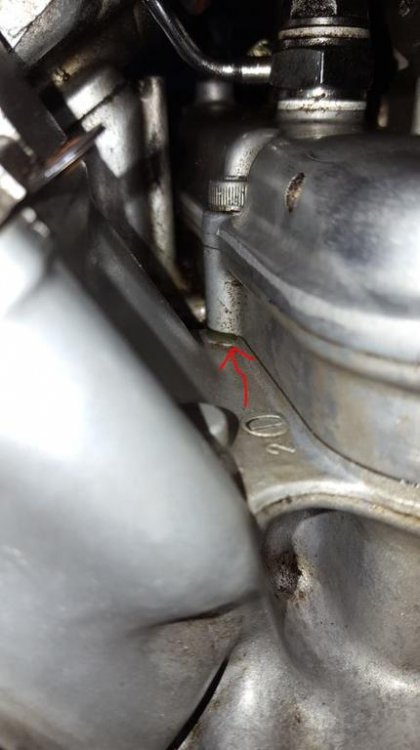

  8. Thanks for all the info - it is as Prairehammer indicated - the update to the breather box and drain tube was never done on my 83. I have ordered the parts needed - the updated breather hose, the t-fitting, some clips. I will re-use the small drain line as indicated in the bulletin - it is still pretty flexible, even after 37 years. And I will seal the boots, as stated in the bulletin. After that - take a look at the carbs. Thanks again!

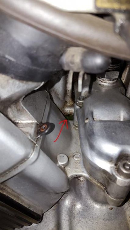

  10. I started working on the twinkie today - got the carbs out, removed and cleaned up the twinkie, and now have a few questions. 1. The Crankcase breather tube is bad and needs replaced. Cannot find a diagram with that part on it. It appears to be a formed hose but not sure. 2. The tube coming out of the crankcase housing that feeds the pressurized oil fitting has an o-ring on it. It looks OK, but would make sense to replace it if I knew what size it was or the part #. 3. When I reassemble the twinkie with the new gaskets, is it appropriate to coat them lightly with a gasket sealer, or best to leave them as is? Thanks for any info or opinions.
  11. Thanks for the info - that is exactly what I needed to know. And while the coolant does not appear to be contaminated, the oil most certainly has to be - the level is completely above the view window - which it was not when I put it up for the winter. So I have drained the coolant (so it doesn't leak anymore into the lube system), drained the oil, and put a piece of tape over the ignition. I haven't planned when I will start the project yet - is there any harm in letting it sit for a while in the present condition? Once the gaskets are replaced, should the engine be flushed to remove any residual coolant from the lubrication system? Sacrifice 4 quarts of oil and a filter - run it for a few minutes and then drain it all out? I am thinking it may be an opportunity to rebuild the carbs as well, but have not looked at the cost of the rebuild kits yet, or everything that is involved with that. It currently runs pretty well, so probably not absolutely necessary, but with 85K they are probably due. I have decided to purchase Big Auggie's 89 Royale so I can still get some riding in this season (plus it is a good upgrade from the 83), and I may have a buddy interested in the 83 once it is running again. Appreciate all the info provided so far (and I am impressed by the Google Drive link, btw). Mark.
  12. I have an 83 Venture(stock, not a Royale), and I have a small coolant leak. It has been very minor and originally only would be noticeable over the winter - I would keep an oil pan under the bike with a couple of paper towels and they would be damp by spring. Last summer it started to leave a drop or two overnight - that is when I started looking. BTW - I had rebuilt the water pump and replaced all the hoses a couple of years ago, so it is not the water pump or related O-rings or fittings. Over this past winter, it was worse – I lost what was in the overflow reservoir plus a little more. It appears to be coming from the front side of the crankcase breather box (I assume that is what that cigar-shaped assembly that sits between the cylinders is). Over a period of several days, the small hollow depression on the front side of the block, visible from the left side, will slowly accumulate green antifreeze (only when the bike is sitting on the big stand. When leaning on the kickstand, it runs down the left side, one drop at a time). I have checked all the lines coming out the top of that box and none have any residue or liquid at the fittings or clamps. The only conclusion I have been able to come to is one of the two gaskets leaks when it cools off. If it leaks when it's hot, it is so slow that it is burning off before you can see it. Does anyone have any experience with this? Can the bolts be retorqued? If so, what is the correct torque (haven't been able to find it in the manual). What would be involved in replacing the gaskets? Can it even be done without removing the carbs, or more? Besides the couple of hose fittings, there is a banjo fitting with two chrome tubes running to the front and back cylinder housings - I assume those are coolant lines, but not sure - is there a write-up on this site that explains what each of these lines are for? I just like to understand what I'm looking at. I did put a small socket on the bolts on the left side to see if there was any play in them, without putting too much effort into it – I fear snapping one of them off and having a real mess – but they wouldn’t budge. Since it seems to be worse when it gets cold, I even tried setting a ziplock bag of ice on the top of the assembly and after half an hour or so later, tried to tighten the bolts on the left side again. The bolt closest to the outside edge did budge just a tiny bit, but the two in the middle still did not move with the pressure I was using. The first picture shows the well about half full of coolant, and the second shows a bit of coolant just under that bolt housing to the left of the well. Thoughts?
