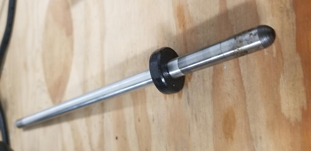

I want to thank all the people who chimed into the thread as there is lots of good advise and to my wife who showed lots of patience working alongside myself who was frustrated to no end. I eventually did get the rubber out of the hole by asking my wife to sit and pick away until it was thin enough that I could then pry the inner washer away (please see initial picture if you are wondering what I am talking about). My advice is to never remove that rubber seal around the rod. I put the bottom end back together and managed to burb the bango 5 times in 1 minutes and it would seem to be bled. I did not open the master cylinder. After topping up the oil I sat back and watched as liquid dripped below the slave cylinder and the middle gear case. I have ordered a new middle gear case gasket and washer for the 6 oclock position but it costs $150 for a new clutch slave from the dealer. I wished I would have read trying to rebuild the slave probably wouldn't fix it. Looks like I will have to keep the master cylinder topped up with fluid until a couple more paychecks enter the bank. Once again I want to thank everyone for your words of wisdom. This might sound like a dumb question but to be sure....the washer goes between the middle gear case and the head of the allen key head bolt (meaning on the outside of the middle gear case)? -
Things are going south and I don't see a thread replacing the seal around the push rod so I have started a new thread. First I'll share a little history. I found my clutch reservoir to be empty so I assumed it was the clutch slave. I rebuilt the slave and bled the system only to find the clutch handle not pressurizing the system so I decided to replace the seal around the push rod in hopes I can figure out why there is no pressure. I have removed the rod out of the hole, scraped the outer rubber away, and tugged with a dental pick & did what I could with a needle nose. That inner seal just won't come out. Here is a picture of the new seal so you can identify what I am talking about. Any idea how to remove the old seal and how to re pressurize my clutch system (or determine why it won't pressurize)?
