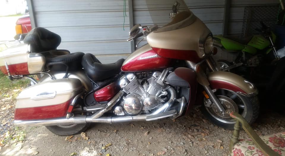

Lookie what showed up on FB marketplace. Only 23K miles in Inwood WV. Wish I had an extra $3500 laying around!!!

That didn't take long to go!!! Good thing, cause I may have been making a road trip for that price!
